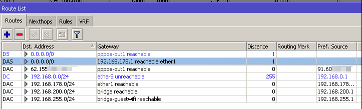

Just found out:
My mikrotik-router is connected via ether1 to my AVM FritzBox, which does not establish a connection by itself, but rather provides PPPOE-PassThrough. So the FritzBox has 192.168.178.0/24 network with DHCP running. Makes only sense to participate in this network to reach out PPPOE and open the FritzBox Webinterface.
Once I enable internet-detection on my mikrotik router, it creates a non-editable - but deleteable - DHCP client for on the 192.168.178./24 network AND it has the checkbox enabled for “add default route”.
With that I had two routes to 0.0.0.0/0:
The fist one makes sense… all non-local connections goe to PPPOE…
The 2nd makes not that much sense: all non-local connections goe to 192.168.178.1… This IP exists …it’s the AVM FritzBox. But as the fritzbox does not establish a connection this would lead to a dead-end.
I removed the non-editable DHCP client entry and created a copy, but without the checkbox for default route. Now the 2nd route is gone.
My guess is, that, as both routes have the same distance and same dest.adress, the router sometimes takes the one, sometimes the other. Until the next PPPOE reconnect.
Will see if this solves my problem permanently.

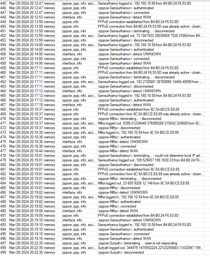

I have a problem with my mikrtotik like this.
For my customer, the usage status is connected, there is no internet on the cellphone but it can be used for browsing.
is there any advice for me?
