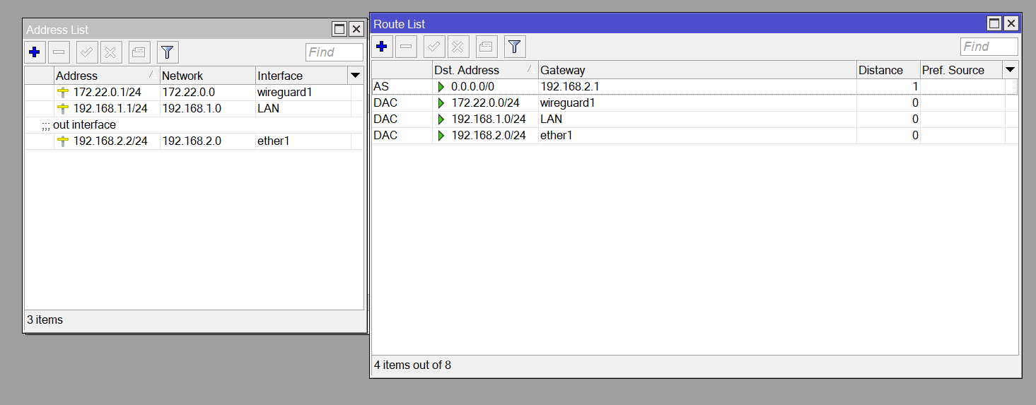

2-see the picture below: this is my ip address and routing table.

Okay so you have a private IP on the mikrotik.
Im assuming you have an ISP modem router of some sort before the mIKROTIK and you are forwarding the wireguard port to 192.168.2.2 (the likely wan IP of the mikrotik)
Post the entire mikrotik config for further assistance.
/export ( minus serial number of mt )
YOu will not have access to the internet through the MT from your windows unless you use 0.0.0.0/0 as an allowed IP address on the windows device for allowed addresses.
Do you not understand how wireguard works??
