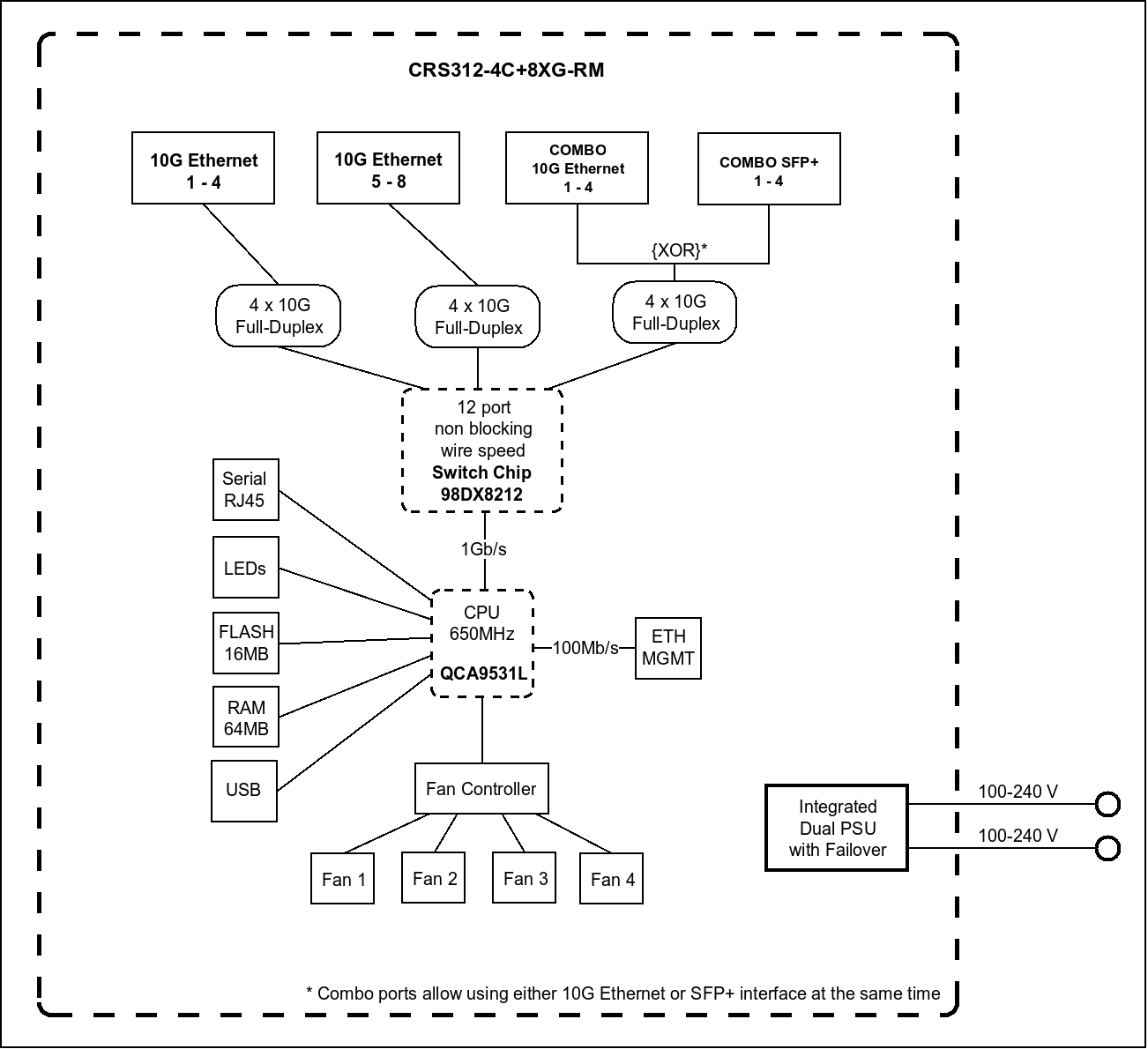

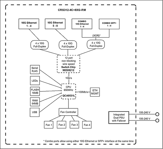

All I am saying is will be wasted as the switch, acting as a router, will not even get 1/2 that from WAN to LAN or LAN to WAN.
Its a 10gb router with a 25gb uplink? I'd expect far more out of it?
Where did you get that impression? It is a switch. It has a weak (single core 650Mhz) CPU for management tasks only.
See the difference between switching and routing performance here.
depending on what you are routing and whether you need firewall, you may be able to use L3HW offloading, but it appears the CRS312 is on the "partial L3HW offloading" list. So I doubt it will work well for an internet connection (but this is just guess, I have never used L3HW offloading on MikroTik)
Layer 3 Hardware Offloading Mikrotik - Deep Dive by Wilmer Almazan / The Network Trip discusses the configuration needed.
Yes, it has great throughput between ports on the switch ( so many devices on the switch passing data back and forth at amazing rates. A switch is not meant for routing data back and forth with the internet.
