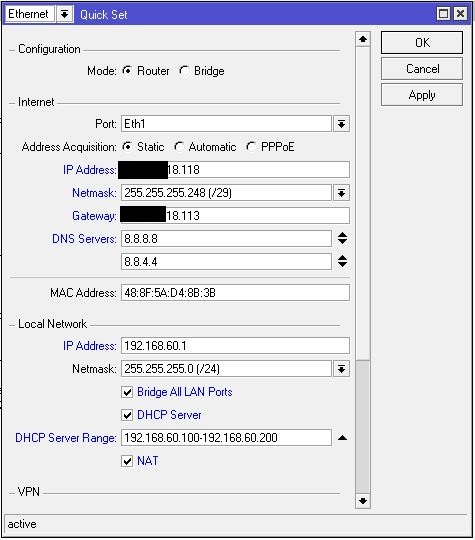

With the MikroTik I thought it should be possible to connect the WAN port (ether1) to the ISP-router and connect all my servers to bridged ports, but I don’t get internetconnection. So I tried to simplify things. My MikroTik is now connected to the switch that is connected to the ISP-router. First I removed the default configuration and after that I run “Quick set” configuration which I set as below:
With this config I am able to ping the other routers (IP: ###.###.18.114-117) connected to the switch, but I am not able to ping anything further. What am I doing wrong?

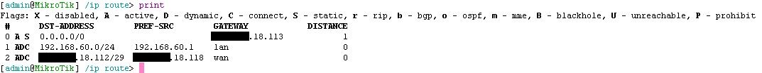

Do you have a default route?
if you do a ‘ip routes print’ in a terminal if look in winbox, do you see an entry for 0.0.0.0/0 and is it pointed to ether1 or the public IP you set for ether 1?

and this is the output of “ip route print”:

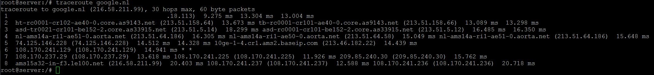

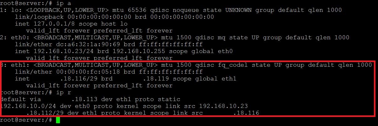

on another linuxbox I have below settings and this works like a charm:
from the Mikrotik I can ping this linuxbox at ###.###.18.116 but nothing else.
on this linuxbox the output of traceroute is:

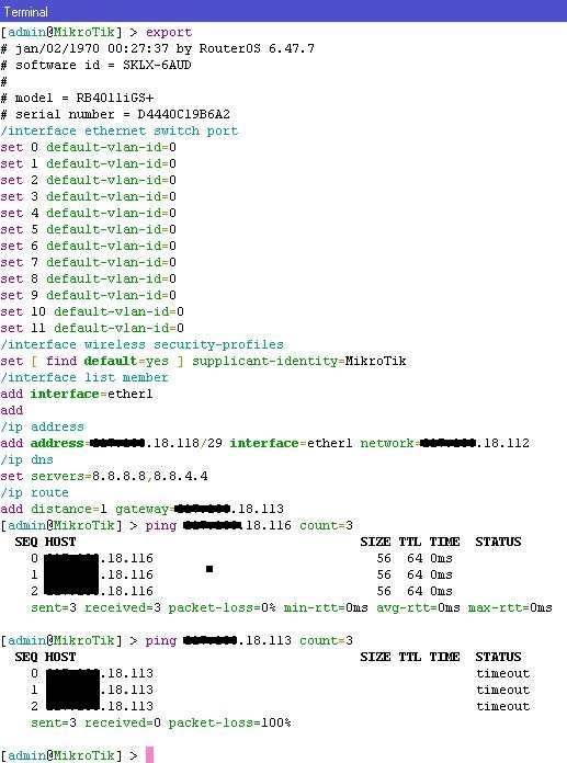

I started again from the beginning with a basic configuration:
As you can see I can ping the other linuxbox, but I cannot ping the gateway.
Is there some other setting wrong?
tell me (or draw) how exactly are connected your router, providers equipment and the “linux box”, please.
Everything else seems ok…

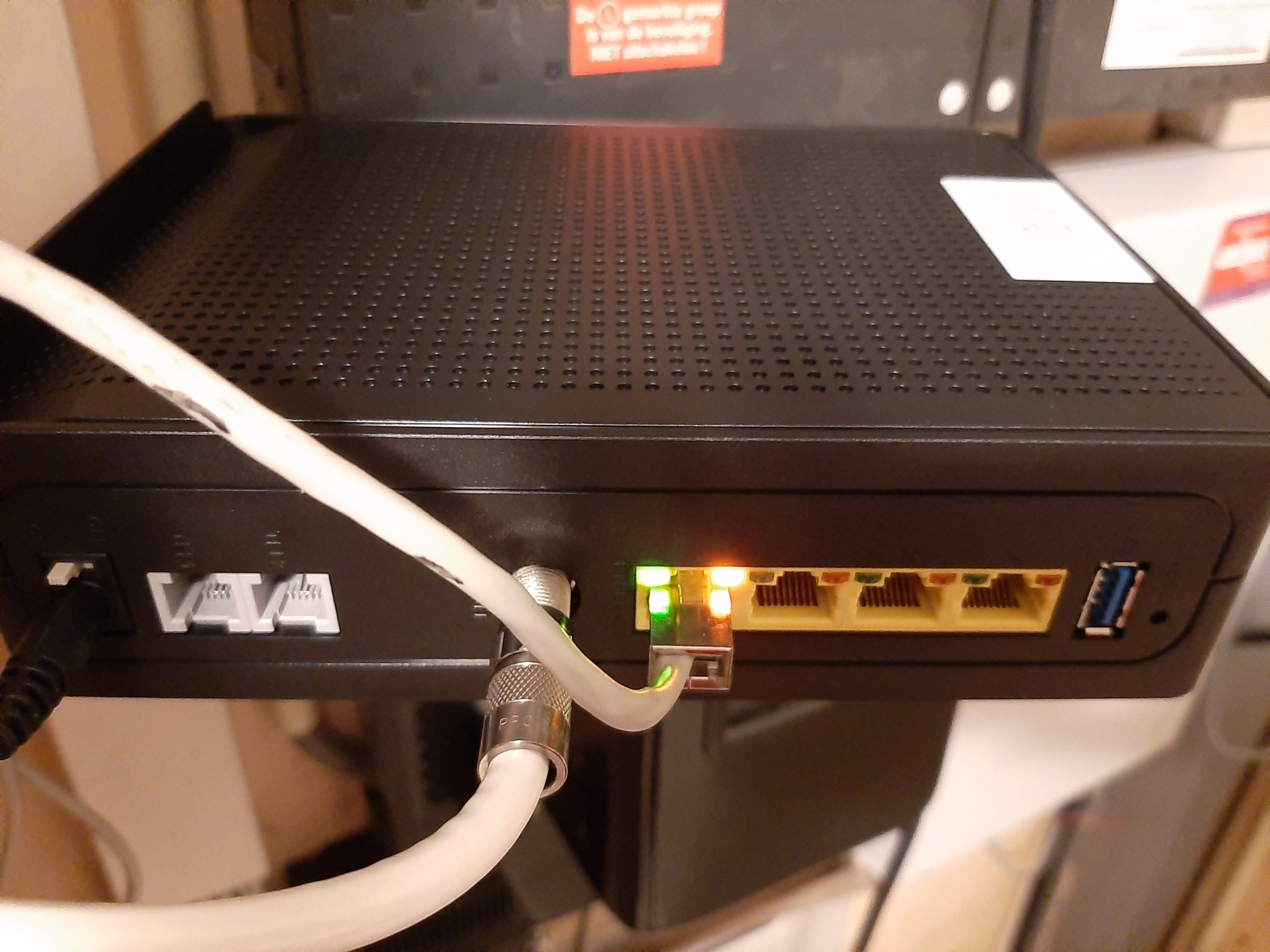

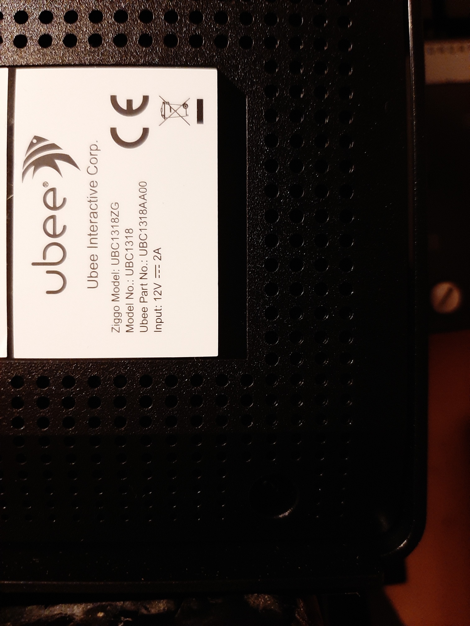

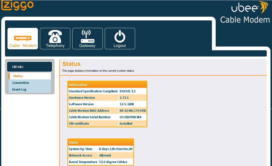

The modem from my ISP:

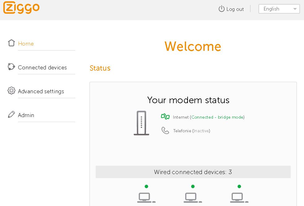

I cannot make any relevant change in the settings of this router:
The UTP-cable is attached to a switch

As I can see you have some kind of Cable modem from your provider and it is in a bridge mode so it is not “dialing a connection” by itself.
If it is anything like adsl modem you have to etup pppoe on modem to connect it to provider, OR if it is bridged (it looks that yours is), you have to set up the connection on your side (in your case - on mikrotik).
If your Linux machine CAN ping outside your network, is it possible that pppoe client is set there?
@satman1w
Yes, it is a cable-modem. I don’t need to setup pppoe. On all the routers / linux-boxes I fill in the correct IP, subnetmask, gateway and dns-addresses and then I have a internet-connection outside my network.
