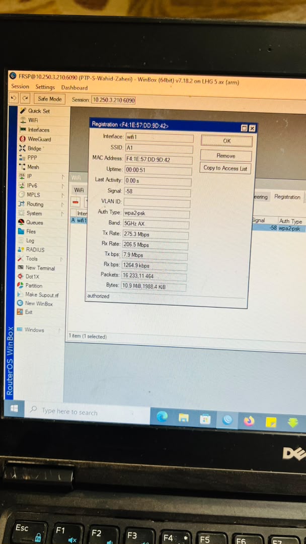

All was about the distance, I just set it and done!
And what is the distance?
11km and just entered
i had 5km and 13km wireless links also, and LHG XL AX repeated its good performance. I'm a Mikrotik reseller, but i love to learn more. I have configured devices for my customers, and then they just placed and it worked
Ok that is short distance and can be fixed in configuration.

I don't recommend AX devices for distances more than 30 km, and I guess we should wait for new updates from Mikrotik. i just set SuperChannel for the highest dBm (about 60 dBm, 5175 MHz- 5895 MHz). In Afghanistan, we have no limit for throughput power for now .
