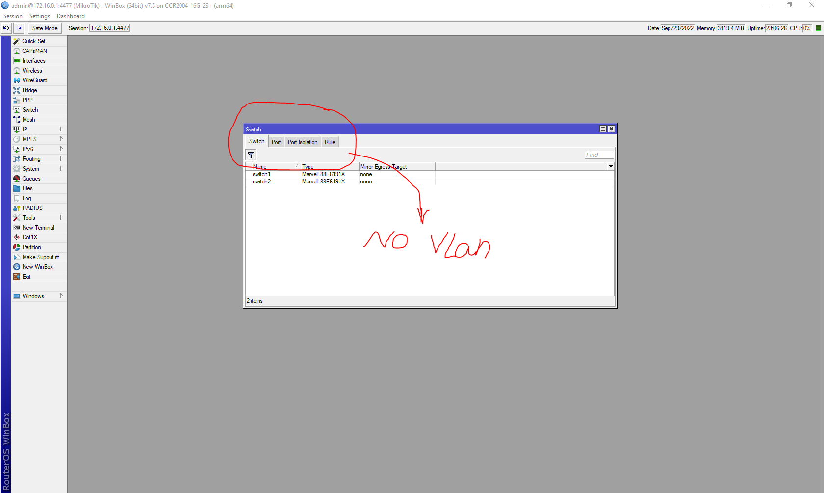

Please help In v7 there is not vlan table in Switch menu.
How or from where I can use or found switch Vlan menu/option
please see the attachment
Mehar
Your ccr features switch chip which supports hardware offliad of L2 (VLANs) and L3 (routing) … hence no need for switch chip vlan tab. Configure VLANs under bridge and it’ll run as optimal as it gets.

Please tell me how I can configure port base vlan as I have attached imgae for this
Go through this tutorial, it should give you pretty good idea about how to do it properly.
