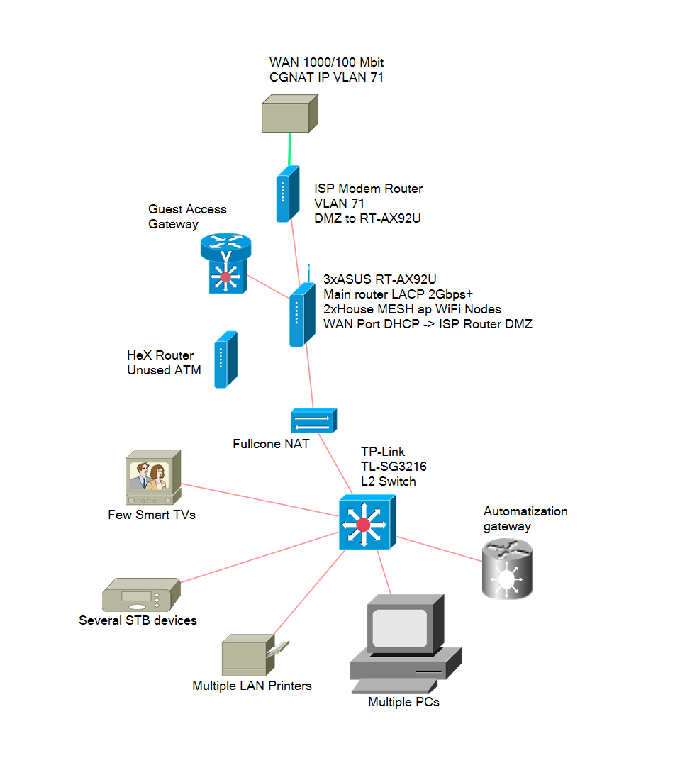

This is current Topology as stating first stage of migration of my working Internet connection.

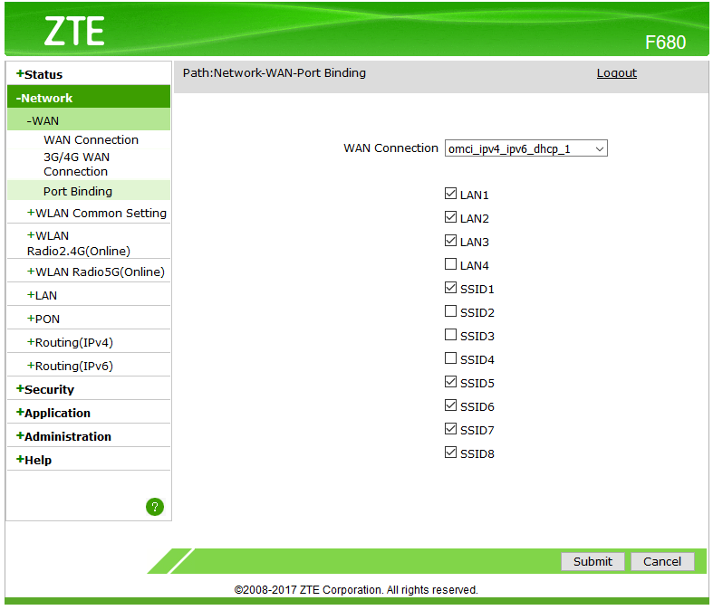

ISP F680 setup pages that drives my current working Internet connection:
Internet work normally
1st stage: During test stages I would like to make this network topology that includes HeX as Main router and look like this:

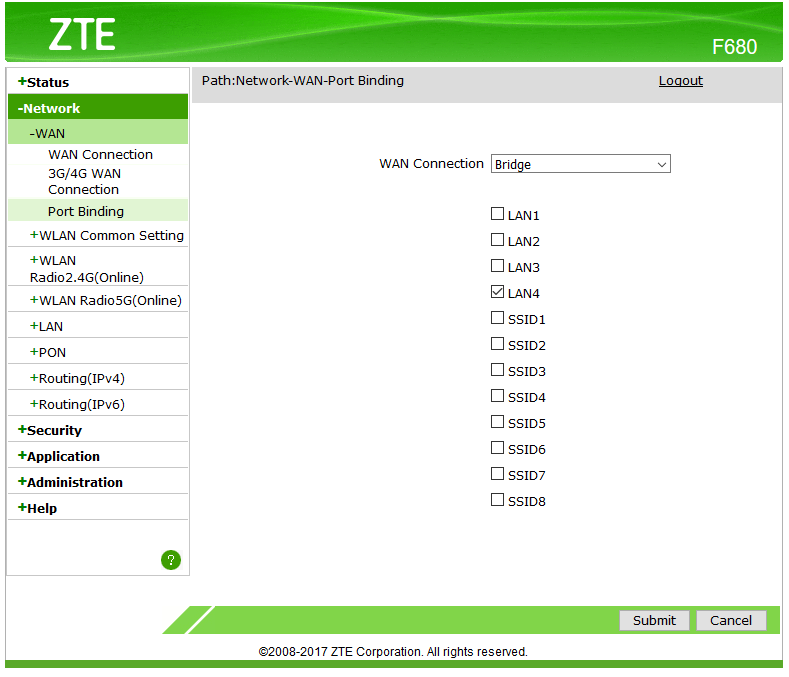

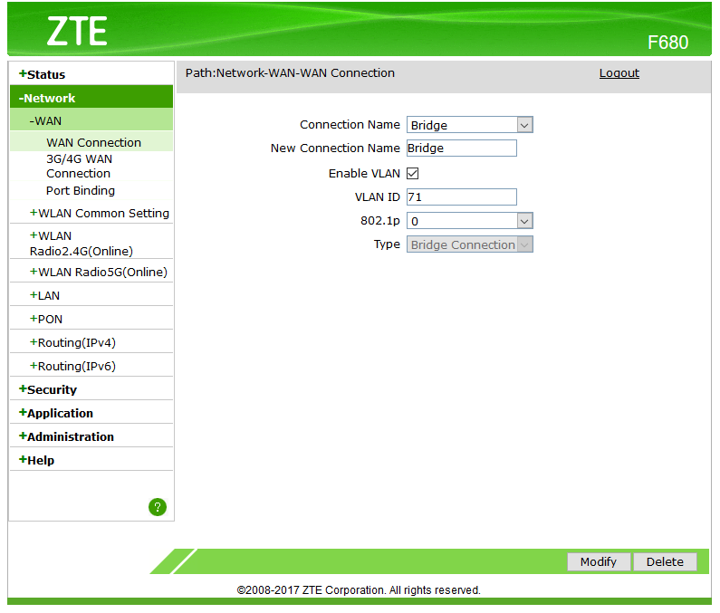

So I created ISP router Bridge Profile and reserved separate port for Bridge:
Tried connecting HeX WAN Port to Bridge port using WinBox:
  1. ip\Firewall - Nat, press “+” and create (Chain-srcnat) (dst addr-192.168.1.0/24) (Out interface - eth0)
  2. gone to the Action tab and in the drop-down menu (Action select - masquarade diud not filled rest → click ok
  3. ip\Routes, click “+” and create a static route to the network 192.168.1.0/24, filling in only (Dst addr - 192.168.1.0/24) and (GateWay - eth0))
Nothing :frowning: No Internet :frowning:
Where I am Mistaking?
