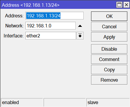

  1. once this setup is complete, the IP address is assigned not to the bridge interface but to the member interface ether2

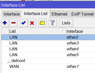

  1. in the Interface List, ether1 stays with the WAN list, despite the fact it’s a member of the bridge now

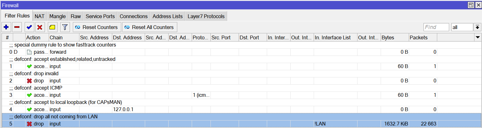

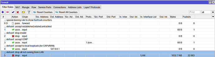

  1. the defconf firewall rule #5 (defconf: drop all not coming from LAN) catches and blocks all the traffic, even if I try to connect to the webfig from an IP range 192.168.1.0/24 AND through an interface that belongs to the LAN Interface List.
I can access webfig only when I add the bridge interface to the LAN Interface List. Here is the config that is automatically set up by the wizard:

  1. it seems to be a good practice to set up the IP address on the bridge interface itself rather than leaving it on the specified etherX interface
  2. the WAN interface list does not make sense for a bridge mode anymore
  3. the webfig should be still accessible to the user through the specified IP after switching to bridge mode.
