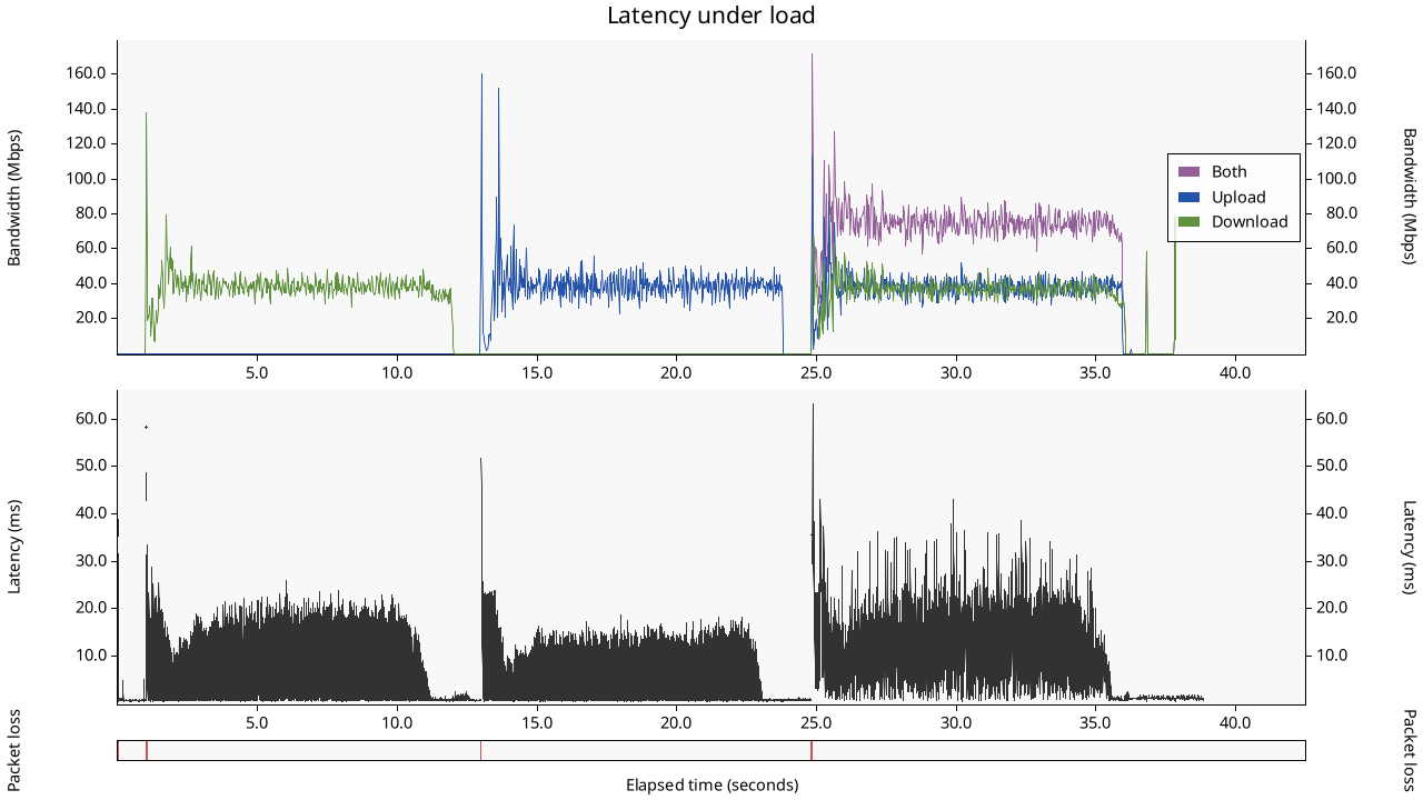

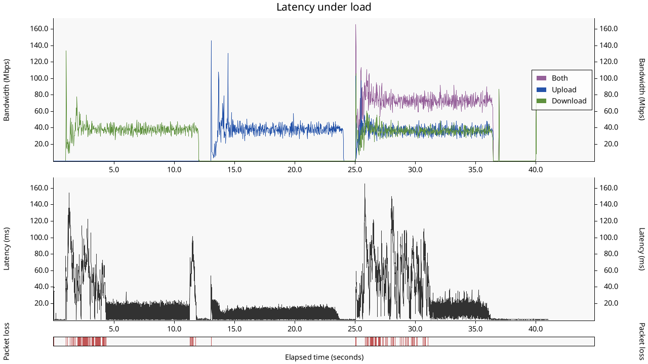

I also saw some odd latency spikes with fq_codel:
These test were done wired to a cAP ac running RouterOS 7.4.

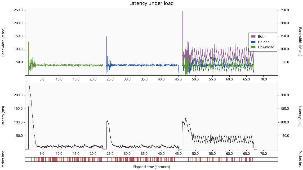

In looking at your crusader data a couple notes made by inference (can you post your config?)
A) On inbound, shaping is less effective than outbound. It’s the nature of the beast. You are going to overshoot at least 200ms with codel in place on a test this extreme,
and taking 4 seconds to get these flows under control at this short rtt is not out of line. Cake has a more abrupt response to that much slow start, might - IF you could use it’s shaper rather than TBF, on inbound traffic, only peak at around 80 or 120ms rather than 200ms on this test.
This is one of those “developments” in the TCP world really overshot what we could do at the AQM level: The world switched to IW10, which made sense (at the time) for some web traffic – https://datatracker.ietf.org/doc/id/draft-gettys-iw10-considered-harmful-00.html and since then pacing has been added, which helps, but then folk started taking on even more packets to the IW (I’ve seen IW70 from some CDNs). A bigger impact on codel’s basic assumptions is that it is tuned to send traffic “around the world”, at the default 100ms interval it only starts degrading “bandwidth equality” at about 260ms RTT.
Your token bucket burst could be overlarge. Don’t like token buckets… But a key thing to note about them is when going from 0 to X they are bursty. If you already at X, new flows should (and there’s a flent test for this) enter it without incurring anywhere near as much delay for themselves.
Still, at short RTTs codel takes a really long time to find the right drop or marking rate. It helps a lot to have a test showing this to be less of a problem in the real world - the staggered start tests I linked to earlier. There is work (L4S) ongoing in the IETF to change ECN to have a more rapid signal than it does today. It’s got tons of problems that I don’t want to talk to today.
Cake has a RTT parameter.
You can indeed fiddle with the interval to something closer to your typical max RTT, but be aware that that hurts longer distance connections while doing so.
Your last result is really puzzling, though. 30sec of oscillation like that… this on ethernet or wifi? this was to, rather than through? What if you tune the inbound shaper down a bit more (at least another 10% to start with). I wish crusader would distinctly show the up vs down latency on this last panel…

are the differences between your ipv6 and your ipv4 run repeatable?
You lost me a bit there. crusader uses a dedicated UDP connection to measure latency.
cAP ac is using the default config (acting as a typical firewall) and I added a simple queue with 40 Mbps up and down max limits with codel / fq_codel queues (both at their defaults). crusader is running on 2 PCs (with Fedora 36) wired in to the LAN and WAN ports.
There isn’t a ISP with bad queueing involved in my test setup, so I don’t see why that would happen. I suspect one of the PCs may produce a more synchronized TCP startup than the other.
I don’t get why token buckets would generate additional latency (for my test setup). There does seem to be extra latency when using HTB to shape vs. using cake to shape however.

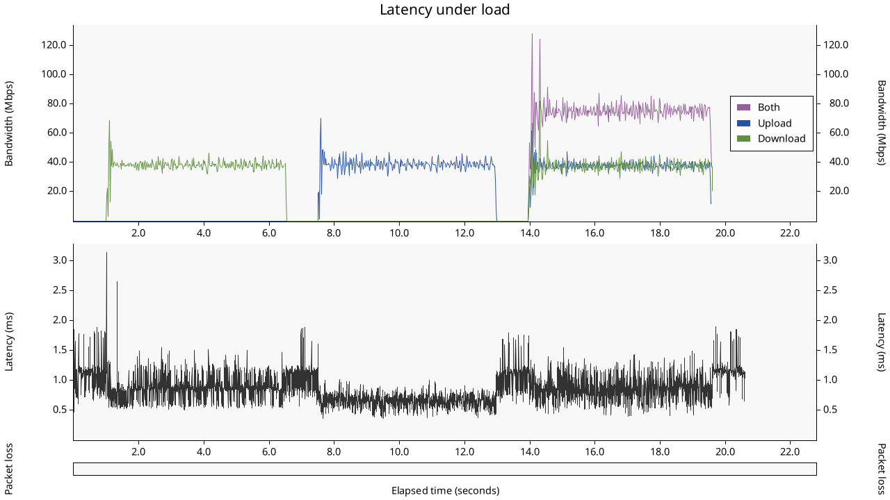

CAKE shaping (10 connections):

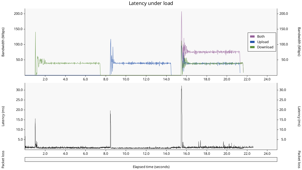

HTB shaping with CAKE queue (10 connections):
The last fq_codel test is done with 100 connections on IPv6, so it’s not really comparable to the first. It could perhaps be explained by hash collisions between connections with loads and the UDP latency measurement connection where the loading connections turn off and on. It happens on every IPv6 test so far and on some IPv4 tests. I’ve not seen it with cake. Here’s a more typical IPv4 result:
Not more than the readme. You can find binaries at https://github.com/Zoxc/crusader/tags however.

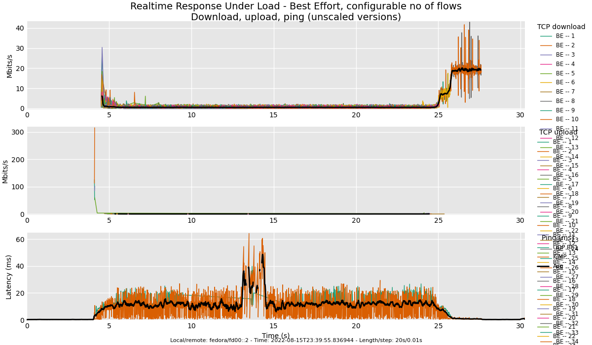

I managed to reproduce some fq_codel spikes with flent (100 connections on IPv6):

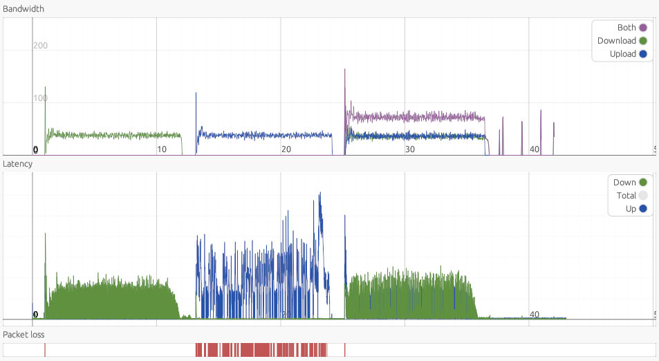

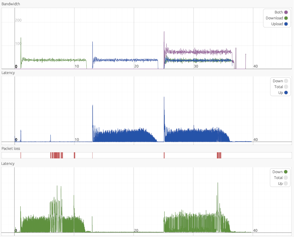

I also implemented measurement of up and down latencies in crusader and redid some fq_codel tests (100 connections on IPv6). 5 tests had spikes on the down latency and 1 on the up latency.
Down latency spike sample:
Up latency spike (behaves more like I’d expect from a hash collision):

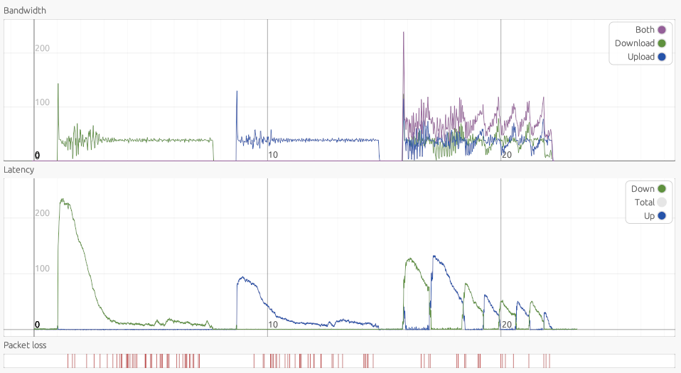

I also redid the codel test with 10 IPv4 connections. You can see the latency oscillate between the up and down directions when both directions are loaded:

  1. I had thought crusader was sampling TCP_INFO, not using another measurement flow. My bad. The “packet loss” you are reporting is actually “measurement packet loss”, not the loss within the tcp flows? When you get a FQ’d network to a state where sparse measurement packets are being lost, you know you are in trouble.
  2. There is a deeply philosophical question about how queues and packets should behave on a 0 length path. Going back to a 10Mbit example, 1.3ms per 1500 bytes,
    gives you enough room for 4 packets with 5.2ms of queueing. Hit that with 100 flows instead. Where are they supposed to go? There’s no “path” to store them in in this case.
a) grow the queue large enough to accommodate 1 packet to all the flows that wish to transit.
b) allow temporarily new flows to transit while hammering harder at the old ones
c) tail drop everything over some arbitrary limit all the time.
d) the perfect answer?
To comment on your first graph. This is case where at least some flows, couldn’t get a syn/ack pair through to start until much later in the test.
I have no idea what went south at t+14. It’s “interesting”. One of my missions in life is to convince folk that the anomalies are very real, and they shouldn’t filter them out but investigate further. Taking that approach would lead to the discovery of the cosmic background bufferbloat radiation: https://theconversation.com/the-cmb-how-an-accidental-discovery-became-the-key-to-understanding-the-universe-45126
In the other graphs - like trying to pound 100 flows through a 4 flow pipe - well, that’s why the generic recommendation is to try and use as few flows as possible to get the job done and let congestion control fill the pipe. The IW10 standard I always thought was far, far too much for most networks, even when it was first proposed. https://datatracker.ietf.org/doc/id/draft-gettys-iw10-considered-harmful-00.html
PS thx for adding the staggerd start facility and working on an android version of crusader!!!
The packet loss measured by crusader is indeed measurement packet loss. I’d probably instrument a QUIC implementation if I wanted some portable metrics. I kind of aim crusader to be more iperf-like with latency metrics than something more flexible like flent though.
The latency spike on the flent graph seems similar to the spikes on the crusader graphs to me, what makes it different?
