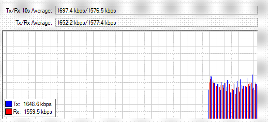

I upgraded a link today, from nstreme to nstreme dual. But I am getting a terriable thruput on the link. before I was getting 25Mb or a little more. With duel running I get at the most 5Mb each way. We upgraded the OS to 3.17 and nothing changed. We setup everything according to the Mikrotik manual.
Please can someone help me find out where we are going wrong, as we need the link fully operational by Wednesday morning.

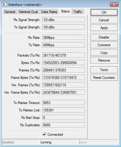

Hi. Please see attachment for the Nstreme Dual configuration.
Both wireless cards on either end have been put in nstreme dual slave mode. Wireless cards running on same frequency as allocated on nstreme dual tab. Using same SSID for both wireless cards per station. Also tried different SSID’s - doesnt seem to make a difference. Also switch nstreme on and off on the wireless cards, but doesn’t effect the Nstreme dual setup. Connection still stays up after making all theses changes. Seems as though when you put wireless cards in nstreme dual slave mode, none of the changes you make on the physical card itself, registers. Only changes made on the Nsteme dual tab in Winbox affects the setup.
Link comes up (shows connected on nstreme dual tab). On the status tab, the RX and TX signal strength are between -55 and -65. (good link). The RX and TX Rate jumps between 54Mb and 48Mb. Seems like a good link. But as soon as a bandwith test is done or actually data flows over the link, the RX, TX rate drops to about 9Mb and the actual bandwith tests shows 5Mb up and 5Mb down (at best!)

PS - Both the frequencies used get about 25Mb when running in bridge - station mode with nstreme on. But together, i just can’t get it working.
nstreme2.TIF (37.6 KB)
nstreme1.TIF (41.7 KB)

Also see attached STATUS bar capture and bandwidth test.

you have problem about interfernce.
lower the TX power for each transmitting card to 6,
you will see the thing goes better!
Then put more power at steps of one db and find the optimal value.
regards
Ros
Lowered the tx power of the main site transmitting card to 6 first. Nstreme Dual connectivity died. Tried going up in 1’s - link only came alive again when i reached 15 power on the main site. Left it at 15 and connected to remote site. When i set the transmitting cards tx power to 15 there, i lost my link. Will have to go out and set back to default to get registration up.
Should the link work with both tx cards set to 6?
yes because your signal was very high!
Tried both sides TX cards at 6 fixed rates and card rates, but link doesnt come up. I played around with higher values, but also no luck. Back to defaults and link up again. This one got me stumped. :frowning:
