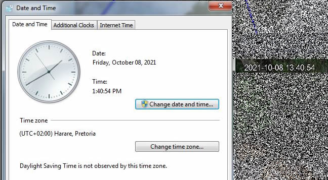

Hi, I’ve just noticed something I want to share.. I use 5 Dahua IP cameras for my CCTV, my IP cams and windows PC’s get its time from the same server, and so does the mikrotik routers… I’ve noticed on mikrotik there is a 4~5sec difference on the clock… Mikrotik is a couple of seconds ahead of all my other devices, they all the same in seconds but only mikrotik differ… why would this be?
I’ve got a couple of routers running, I use ROS v6.44.6 and v6.47.9… both ROS versions does the exact same thing with the 4sec ahead vibe going on!!!

Where you read the clock? On the video?
Some seconds of differencies can be possible, because the image is processed before you can seee it on video…

nope, I’m running live, direct from the cameras
See attachment
