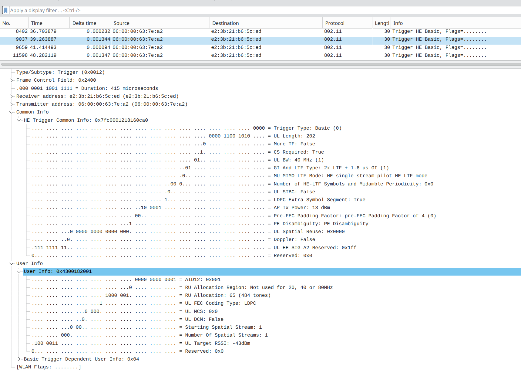

Whit questions like this we need sniffing:
As we can see, RUs are at least assigned to user upload, so I assume OFDMA is there and working.
