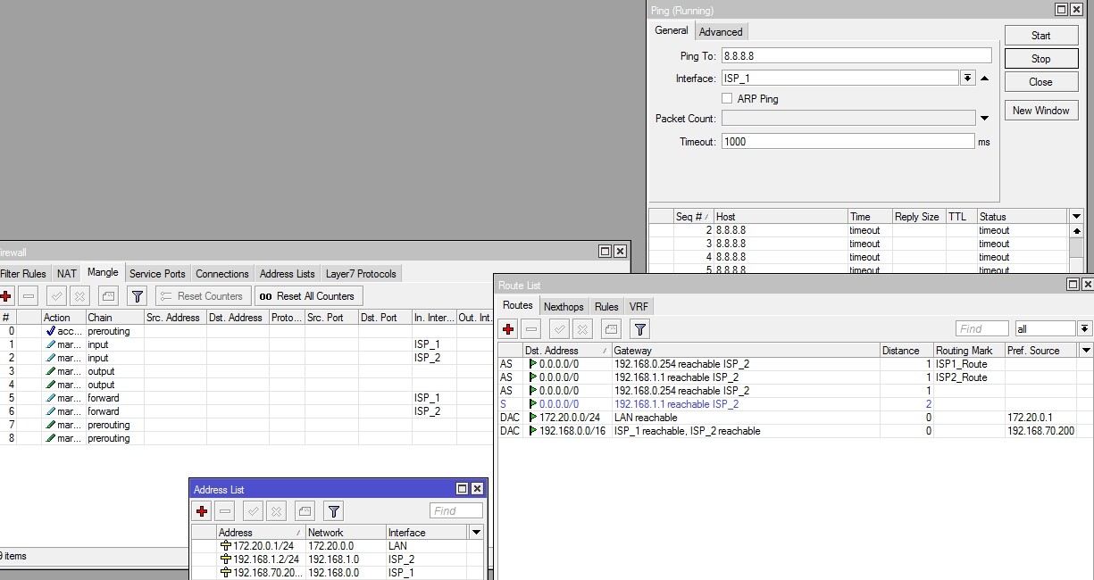

Here is the exported config, as requested.
I noticed, even before running the script, with GW1 and GW2 distanced set to 1 and 2 respectively, I cannot ping an IP over GW2 until I change the distances to 2 and 1 (making GW2 the priority) - why is this?

Hi tomaskir,
Thanks for the advise I had a look at your presentation pdf, and copied the console commands as close as possible, yet up until before page 38 - since I don’t want load balancing, only automated fail-over (and restore).
Yes, the same problem persists, when ISP1 is the primary connection, I cannot ping out of ISP2’s interface.
Here is my mangle and routing rules:

Your mangle is still not right. Since you arent doing the actual topology in my presentation, but a different thing, you need to modify the mangle, the presentation was just an example so you could see how the whole thing is supposed to work.
Put just this in your mangle.
/ip firewall mangle
add chain=prerouting dst-address-list=Connected src-address-list=Connected
add action=mark-connection chain=input connection-mark=no-mark in-interface=ISP_1 new-connection-mark=WAN1->ROS
add action=mark-connection chain=input connection-mark=no-mark in-interface=ISP_2 new-connection-mark=WAN2->ROS
add action=mark-routing chain=output connection-mark=WAN1->ROS new-routing-mark=ISP1_Route
add action=mark-routing chain=output connection-mark=WAN2->ROS new-routing-mark=ISP2_Route
add action=mark-connection chain=forward connection-mark=no-mark in-interface=ISP_1 new-connection-mark=WAN1->LANs
add action=mark-connection chain=forward connection-mark=no-mark in-interface=ISP_2 new-connection-mark=WAN2->LANs
add action=mark-routing chain=prerouting connection-mark=WAN1->LANs new-routing-mark=ISP1_Route src-address-list=LAN
add action=mark-routing chain=prerouting connection-mark=WAN2->LANs new-routing-mark=ISP2_Route src-address-list=LAN
That will make your router and LAN (if you do some NATs) accessible from both ISPs. You dont need any more mangle, since your LAN → WAN connections will always stay in the “main” routing table.
The rest of your setup is OK, so the script should now work fine. Example from one of our routers here. (I have more routes in each WAN routing table because of load-balancing)

Okay, so as per the above code, here it is made live… yet, it’s still not working…
I also wanted to ask, what’s the purpose of, and why is it required:

add address=172.20.0.1/24 interface=LAN
add address=192.168.1.2/24 interface=ISP_2
add address=192.168.70.200/16 interface=ISP_1
set allow-remote-requests=yes servers=8.8.8.8,8.8.4.4
/ip firewall mangle
add chain=srcnat out-interface=ISP_1
add chain=srcnat out-interface=ISP_2
add distance=1 gateway=192.168.0.254 routing-mark=ISP1_Route
add distance=1 gateway=192.168.1.1 routing-mark=ISP2_Route
add distance=2 gateway=192.168.1.1
What I find interesting, is that all the routes, as going through ISP_2, even though ISP_1’s gateway is only available on eth1.
