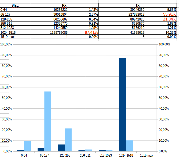

I checked my stats for 3 months (last reboot) from my router acting as a PPPoE client to ISP and routing traffic to my other routers. All of them have public IPs. Main router used for home office work + mobiles, VPNs to service my clients, streaming etc., typical SOHO mixed usage. Some other devices are test routers but they generate very small traffic. Lucky me: MTU for PPPoE is 1492. Ethernet interfaces set to maximum values.
Packet size split for circa 1.7TiB in / 93GiB out
