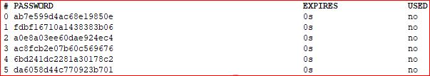

It seems to store each run in this view for some time:
/certificate scep-server otp print
# PASSWORD                                                                                                                EXPIRES              USED
 0 677d57c658119f4f8804                                                                                                    0s                   no
 1 bd4a331ef703af86d1ac                                                                                                    0s                   no
 2 7bcc23c0b21d3628154b                                                                                                    0s                   no
 3 9004db9d316482e341a4                                                                                                    0s                   no
 4 3347c7c2465cd6696fc4                                                                                                    0s                   no
 5 cfeb7c719712b1fda4cd                                                                                                    0s                   no

Alternatively, but they are removed automatically after a few seconds if you use “minutes-valid=0”
That did not work for me and the generated passwords stay in the list despite it has counted down to zero.
It is not that easy to remove those passwords and the problem is that sometimes the generated password is not yet displayed in the list. Then I get the error that the item does not exist. I am still trying to find a good way like using on-orror so that the script keeps running.
Update: it comes even stranger when I add in Winbox with a 0..4294967295 (unsigned long integer) minutes timeout. It is starting to increase the counter. Terminal is still showing zero.
I am on 6.48beta48 so that could be different than other versions.
