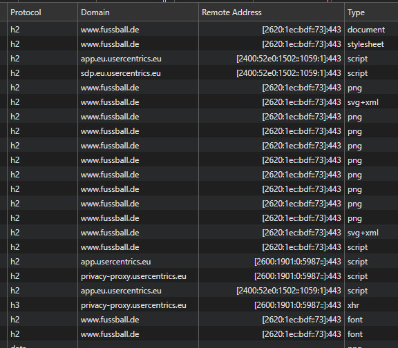

I have this one website that I can’t access, it’s www.fussball.de a German website about amateur football.
If I switch off IPV6 on my Win11 PC, the page can be accessed, but as soon as I activate IPV6 again, the page times out.

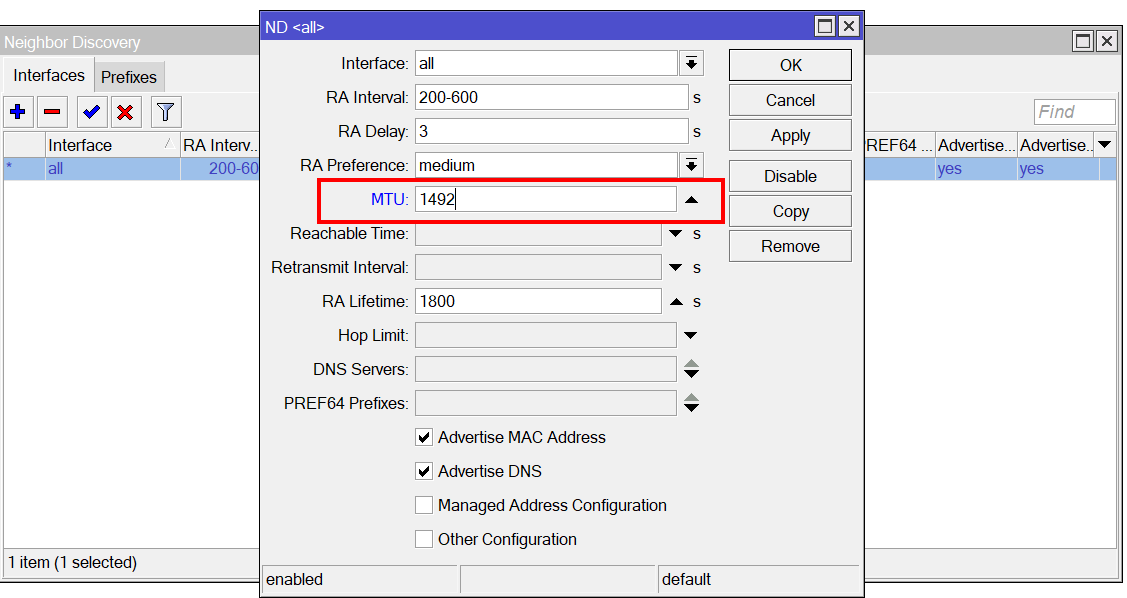

I don’t see an attached configuration, but I’m willing to predict that if you compare yours to mine, you’ll find the relevant discrepancy.
Thx for answering so quickly, checked your linkand my config mostly matches the one described there. However, I have several vlans so I can’t stick to it completely.

Pls note, I can reach IPV6 sites, only www.fussball.de is driving me crazy, at least it is noticeable on that website.

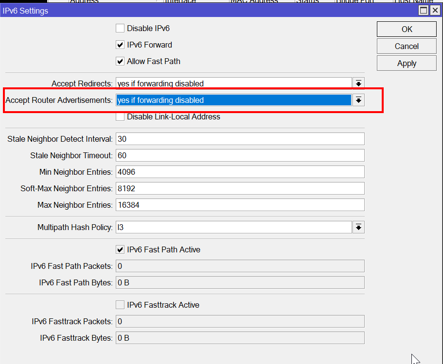

It looks to me as if there is now a duplicate entry for the default gateway
That’s because you also have NDP set to accept RAs, which also has this effect. What’s new is that your clients should now be learning that the gateway’s GUA is the default route, where before they had the freedom to choose.
It is possible you might have to reboot the gateway to make everything come into proper alignment.
I happened to run into this very trouble about a day before you started this thread. I’m not guessing here; this is what fixed it for me.
okay, I switched this setting from “yes” to “yes if…”
now it looks like this

That amounts to “no” because as you see from your own screenshot, IPv6 forwarding is enabled.
I don’t like that setting at all. It’s confusing to the point of being near-magical. Say yes, or say no. Be explicit.
So I should set it to yes or no?

Your issue that only happens with one website might be MTU related. Because you are using PPPoE for your WAN and I don’t see max-mru=1500 max-mtu=1500 in your /interface pppoe-client instance, the actual MTU of the WAN connection is probably smaller than 1500. In that case:
  • Either try to set max-mru=1500 max-mtu=1500 on pppoe-WAN to see if you can achieve an Actual MTU value of 1500 with RFC 4638.
  • If MTU=1500 is not possible on pppoe-WAN (RFC 4638 not supported by your ISP), modify the current IPv6 → ND default instance so that it announces an MTU value equals to the Actual MTU value of pppoe-WAN (for example 1492).

I set max-mru=1500 max-mtu=1500 on pppoe-WAN but it remains on an actual MTU of 1492.
Do you mean this setting?
After changing this it looks like this:

Yes, that setting. Normally with IPv6 the hosts should perform Path MTU Discovery with the help of ICMPv6 (which your firewall is correctly not blocking) but sometime some hops on the way might not behave correctly and break it. In that case you can tell your LAN clients to reduce the MTU for IPv6 (IPv4 is not affected) by advertising that value together with RA.
Yes, that is normally what the default route should look like when you use PPPoE for your WAN.
After setting MTU in IPV6-ND to 1492 fussball.de is reachable again.
I hope that the site remains accessible.
Many thanks to all of you in the meantime, it is very much appreciated.
I will definitely be in touch again.
