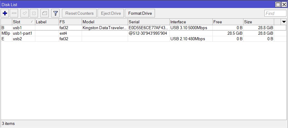

That USB3 stick has been formatted on your device with ext4 filesystem ?
When you do the extraction part, you should see in Files where it puts the files.
Yes, it’s formatted in ext4 format, here is Disk List screenshot:
I don’t know what is this USB2…

Tried today with adguard container… Same error… I can’t install any container
Please monitor system resources while pulling container image. Does router hdd free space not shrink?
I see that free space on USB stick go from 28.8 GB to 28.5 GB, that’s it. I set TMP folder to USB disk so i have plenty of disk space.
So, i replaced USB and now it’s working… I formated drive to ext4, like previous one…
