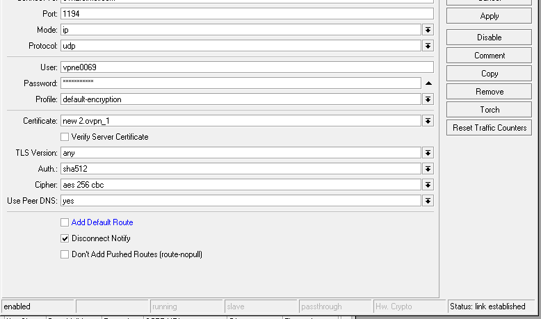

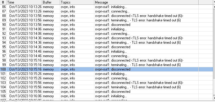

I have a miktrok wireless AP: RBcAPGi-5acD2nD, I want to use it for works with openvpn connection to my office. my company provided me a .ovpn file. I imported it to my laptop and regular linksys router then vpn connection established successfully. however, when I imported it to above AP router, keep getting error msg “TLS error: Handshake Timed out” in log. ’
after I reviewed the.ovpn file, the TLS version is 1 but without AUTH encryption info. In Mikrotik Router, TLS version is ANY and 1.2 ONLY and 5 Auth Encryption: MD5, Null, SHA1, SHA256 and SHA512. I tried all of them but connection still cannot established.

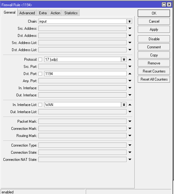

I already upgraded my wifi ap firmware to latest 7.11.2. the port 1194 is enable in firewall rule.

Why did you open the port? Assuming you want to connect the router to the office?

On one mikrotik it says “TLS handshake timed out” , on other mikrotik works good .
this happens only if i use UDP
