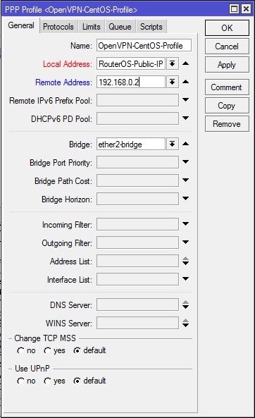

I am looking at this right now actually.. Trying to give an OpenVPN client (Mikrotik as server) a static IPv4 and IPv6 address..

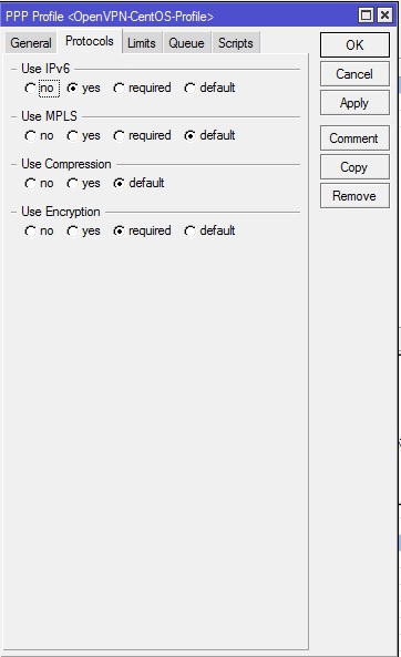

In the Profile setup.. There is “Remote IPv6 Prefix Pool” and “DHCPv6 PD Pool” Also ‘Protocols’ “Use IPv6”..
This indicates there is some support.. lol My trick is trying to figure out how to assign a specific IP from the prefix to the OpenVPN client..
Different issue, yes, but that is how I got here..
PPP profiles are used for all VPN types. They do have IPv6 options, but so far those don’t do anything for OpenVPN.
Mine, RouterOS (server) to CentOS (client) is giving my CentOS VPS IPv6…
I’m still trying to figure out how to ‘push’ certain parameters to the client, but no issue with IPv6 over OpenVPN

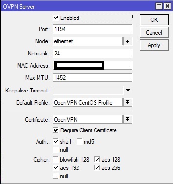

I shall try.. Tags with forum software is a weak point so hopefully this looks ok..
I am also still making small tweaks, so this won’t be my final config.. lol Still just a work-in-progress (My CentOS server needs to have static LAN IPs, so not using an IP pool, as an example)

But yes, it is ‘Ethernet’ mode..
So.. Possible to assign IPv6 with OpenVPN
