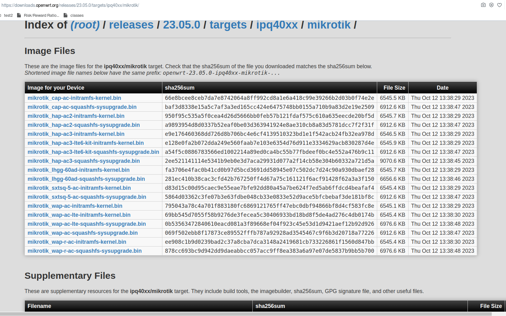

Update:
Just found this: ac3 is already supported. Check “ac3” in table below or at https://downloads.openwrt.org/releases/23.05.0/targets/ipq40xx/mikrotik/ :
Thank you.
