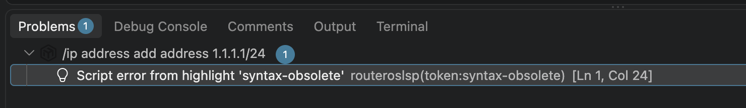

The issue, if one wants to be faithful to what RouterOS accepts as valid... this whole concept that "equals in arguments are options" through a wrench in the scheme. Since no docs EVERY show this "equal-less args" syntax, it a bad idea to start writing scripts this way.
See my existing RouterOS LSP, using /console/inspect request=highlight to determine validity of scripts (on top of how to colorize the script). I'd glossed over this a while back, and just treated syntax-obsolete as a hard error:
But, via testing, scripts > 24K take many seconds to calculate. So the newer approach to use :parse to determine validating (with request=highlight handling colors still). But what this found is that "equal-less args" are accepted, so syntax-obsolete is not actually a "true" error.
For example, taking the above, the following two statements result in the exact same code running on RouterOS:
/system/script; add name beep source { :beep }; run beep
/system/script; add name=beep source={ :beep }; run beep
And if you :put [:parse "..."] the above two lines, both return the same "ParseIL" (:typeof is (code)):
/system/script/;(evl /system/script/addname=beep;source= :beep );(evl /system/script/runnumber=beep)
So not that I unwind this problem, it more then just do/else blocks. These "equal-less args" seem pretty universally accepted...
