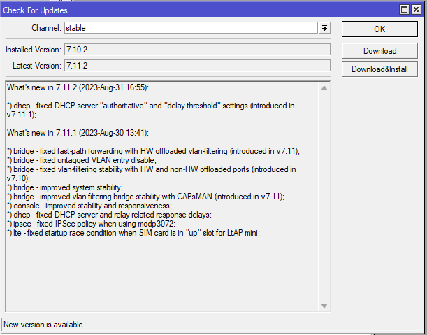

I’m using hAP ac^3 V7.10.2.
When trying to do System → Packages → Check for updates
Selecting “Stable” I see this:
Selecting “Download & Install” will show that the update is being downloaded, then the router reboots but the version stays the same.
I tried uploading the updates packages manually via packages but still, nothing actually changes after reboot.
any suggestions?
