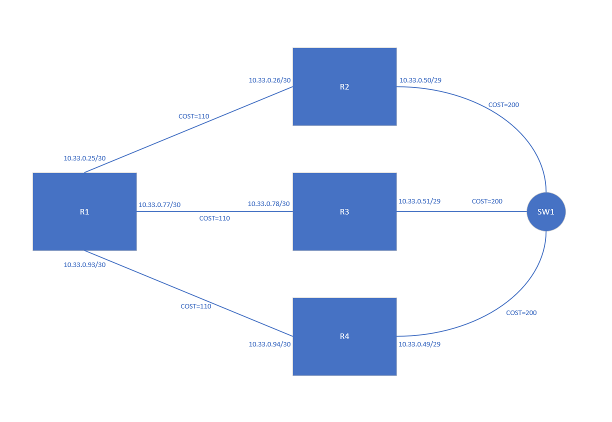

I have a problem with OSPF on a part of my network.
The simplified design is as per the diagram attached. OSPF configuration is listed below. RouterOS is on the latest version.
R1 is connected to R2, R3 and R4 via VLANs over different physical fibre links.
R2, R3 and R4 are connected to each other via a common VLAN to a switch.
R1 distributes the default route to R2, R3 and R4.
R2 distributes connected and static routes to R1.
R3 distributes connected and static routes to R1.
R4 distributes connected and static routes to R1.
R2, R3 and R4 distributes connected and static routes between each other.
I want to use the “switched” connection as backup default route (via R2, R3 or R4) for R2, R3 or R4 only if their main fibre link goes down.
If I enable “redistribute-default” on the R2 router, the R3 and R4 routers get a ECMP default route via the main fibre as well as via the switched connection, this then load balances the default route traffic, which is not what I am looking for. When checking the OSPF metric in columns, the metrics are different, but the default route is still in ECMP. I have tried changing link costs and priority and the problem persists.

Same problem. We have Failover set up over two links, but thanks to ECMP the COST set on the interface is ignored and data flows randomly between the two routers, where both default-routes have a distance of 110, but the OSPF metric is 10 vs 20000. So instead of “failover” we have “load balancing”. A broken ECMP is to blame, which cannot be turned off.
