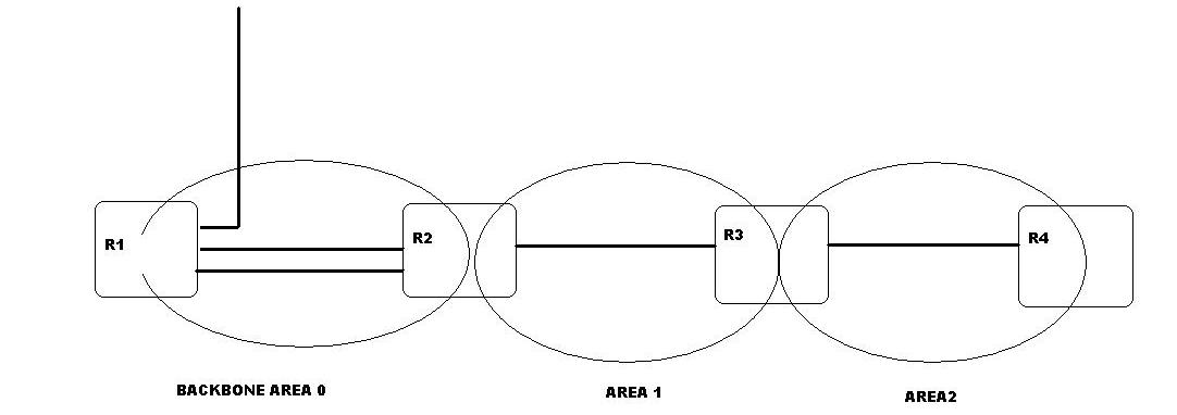

Hi guys,
I’ve a trouble setting an ospf network, more precisely using virtual link which has affected by bug.
My network is shown below:
How can I do a link/tunnel to interconnect the area 2 to backbone area?
I’m trying to establish that using GRE Tunnel but without good result.
Someone have a solution for me?
If they wants an export compact of configuration please tell me
P.S:sorry for my bad english
Send me your export. I have a similar configuration running just fine.
Thanks for your interest!
So, here I attach the export compact for every router:
R1

As you can see I’ve tried to establish GRE tunnel (now disabled only on ospf) betwenn R2 and R3 (area1) but with no good result, only starting a ping on GRE interface i can reach the remote end (R4).I hope in your help…
Thanks for your support!
Regards
