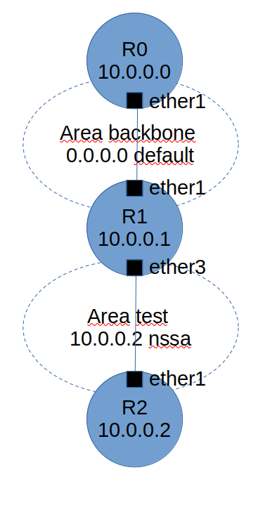

Hello. I am experiencing some difficulties after upgrading to version 7.1.1
I put together a test lab with CHR and test on it.
Network schematics:
I expect to see the network 10.123.123.0/24 at R0 and R1, which I redistribute at R2
The problem is that I can’t see the route at R0 but I can see it at R1.
Routing table on R0:
[admin@R0] > /ip/route/print
DST-ADDRESS GATEWAY DISTANCE
DAd 0.0.0.0/0 172.16.200.1 1
DAc 10.0.0.0/32 loopback0 0
DAo 10.0.0.1/32 10.1.0.2%ether1 110
DAo 10.0.0.2/32 10.1.0.2%ether1 110
DAc 10.1.0.0/30 ether1 0
DAo 10.1.0.4/30 10.1.0.2%ether1 110
DAc 172.16.200.0/24 ether2 0
Routing table on R1:
[admin@R1] > /ip/route/print
DAo 10.0.0.0/32 10.1.0.1%ether1 110
DAc 10.0.0.1/32 loopback0 0
DAo 10.0.0.2/32 10.1.0.6%ether3 110
DAc 10.1.0.4/30 ether3 0
DAo 10.123.123.0/24 10.1.0.6%ether3 110
But I see the loopback routes everywhere. Is this a bug in the ROS or in the configuration?

Redistribution into an NSSA area creates a special type of link-state advertisement (LSA) known as type 7, which can only exist in an NSSA area.
Thank you, i’ve changed area type to default.
