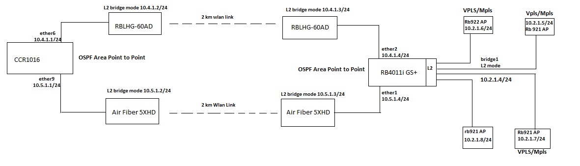

I have the following scenario shown on the picture, my network is OSPF routed and I have VPLS/MPLS to my end points Access Points.
Now the challenge is that I want to split the 300 Mbps traffic trough two parallel wireless links. With this setup failover works good, when I disable one of the interface all traffic is routed to another wireless link .
At the moment the whole traffic is coming through RBLHG 60 AD, but this is not what I want, the point is that 150 MBps should go trough RBLHG-60AD and rest 150MBps goes trough AirFiber 5XHD. I don’t know if possible to steer the traffic to specified AP devices. For example I need traffic from AirFIber 5xHD to be routed to AP1 and Ap2 and the rest traffic from LHG60AD to be routed to AP3 and AP4.

These are my config setup.
CCR1016
add address=10.1.255.1 interface=Loopback0 network=10.1.255.1
add address=10.5.1.1/24 interface=ether9 network=10.5.1.0
add address=10.4.1.1/24 interface=ether6 network=10.4.1.0
/routing ospf area
add area-id=2.2.2.2 default-cost=1 inject-summary-lsas=yes name=area2 type=stub
/routing ospf instance
set [ find default=yes ] router-id=10.1.255.1
/routing ospf interface
add interface=ether9 network-type=point-to-point
add interface=ether6 network-type=point-to-point
add interface=Loopback0 network-type=point-to-point passive=yes
/routing ospf network
add area=backbone network=10.1.255.1/32
add area=backbone network=10.255.255.0/24
add area=area2 network=10.4.1.0/24
add area=area2 network=10.5.1.0/24
/mpls interface
set [ find default=yes ] interface=ether9 mpls-mtu=1550
add interface=ether9 mpls-mtu=1550
add interface=ether6 mpls-mtu=1550
/mpls ldp
set enabled=yes lsr-id=10.1.255.1 transport-address=10.1.255.1
/mpls ldp interface
/interface vpls
add advertised-l2mtu=1508 disabled=no l2mtu=1508 mac-address=00:00:00:00:02:01 name=CCR->AP1 remote-peer=10.1.255.5 vpls-id=20:5
add advertised-l2mtu=1508 disabled=no l2mtu=1508 mac-address=00:00:00:00:02:01 name=CCR->AP2 remote-peer=10.1.255.41 vpls-id=20:41
add advertised-l2mtu=1508 disabled=no l2mtu=1508 mac-address=00:00:00:00:02:01 name=CCR->AP3 remote-peer=10.1.255.18 vpls-id=20:18
add advertised-l2mtu=1508 disabled=no l2mtu=1508 mac-address=00:00:00:00:02:01 name=CCR->AP4 remote-peer=10.1.255.19 vpls-id=20:19
RBLHG-60AD 10.4.1.2/24
Setup config
add name=bridge1
set [ find default-name=ether1 ] speed=100Mbps
/interface w60g
set [ find ] disabled=no frequency=64800 mode=bridge name=wlan60-1 password=xxx region=eu ssid=MikroTik60
/interface w60g station
add mac-address=B8:xxx:F4:95:xx:B3 name=wlan60-station-1 parent=wlan60-1 remote-address=B8:69:xx:95:xx:5A
add bridge=bridge1 interface=wlan60-station-1
add address=10.4.1.2/24 interface=bridge1 network=10.4.1.0
add distance=1 gateway=10.4.1.1
RBLHG-60AD 10.4.1.3/24
add name=bridge1
/interface w60g
set [ find ] disabled=no mode=station-bridge name=wlan60-1 password=xxx region=eu ssid=MikroTik60
add bridge=bridge1 interface=wlan60-1
add address=10.4.1.3/24 interface=bridge1 network=10.4.1.0
RB4011i GS+
Setup config
add bridge=bridge1 interface=ether3
add bridge=bridge1 interface=ether4
add bridge=bridge1 interface=ether6
add bridge=bridge1 interface=ether7
add bridge=bridge1 interface=ether8
add bridge=bridge1 interface=ether9
add bridge=bridge1 interface=ether10
add address=10.2.1.4/24 interface=bridge1 network=10.2.1.0
add address=10.4.1.4/24 interface=ether2 network=10.4.1.0
add address=10.1.255.51 interface=loopback network=10.1.255.51
add address=10.5.1.4/24 interface=ether1 network=10.5.1.0
add distance=1 gateway=10.2.1.1 pref-src=10.2.1.4
/mpls interface
add interface=ether2 mpls-mtu=1550
add interface=ether1 mpls-mtu=1550
add interface=bridge1 mpls-mtu=1550
/mpls ldp
set enabled=yes lsr-id=10.1.255.51 transport-address=10.1.255.51
/mpls ldp interface
/routing ospf area
add area-id=2.2.2.2 default-cost=1 inject-summary-lsas=no name=area2 type=stub
set [ find default=yes ] router-id=10.1.255.51
add interface=ether1 network-type=point-to-point
add interface=ether2 network-type=point-to-point
add interface=loopback network-type=point-to-point passive=yes
add interface=bridge1 network-type=broadcast
add area=area2 network=10.2.1.0/24
add area=area2 network=10.1.255.51/32
AP1 10.2.1.6/24
add name=Loopback0
add admin-mac=4C:xx:0C:xx:7B:AD auto-mac=no fast-forward=no name=bridge
set [ find default-name=sfp1 ] disabled=yes
/interface vpls
add advertised-l2mtu=1508 disabled=no l2mtu=1508 mac-address=00:00:00:00:02:05 name=AP1 remote-peer=10.1.255.1 vpls-id=20:5
add authentication-types=wpa2-psk eap-methods="" management-protection=allowed mode=dynamic-keys name=profile1 supplicant-identity="" wpa-pre-shared-key=\
xx wpa2-pre-shared-key=xx
/interface wireless
set [ find default-name=wlan1 ] adaptive-noise-immunity=ap-and-client-mode ampdu-priorities=0,1 antenna-gain=19 area=10 band=5ghz-n/ac country=xxxx\
default-forwarding=no disabled=no frequency=5420 frequency-mode=superchannel installation=outdoor mode=ap-bridge multicast-helper=disabled \
nv2-cell-radius=10 nv2-downlink-ratio=70 nv2-preshared-key=xx nv2-security=enabled scan-list=5100-5900 security-profile=profile1 ssid=XXX \
wireless-protocol=nv2
/interface wireless nstreme
set wlan1 enable-nstreme=yes
/routing ospf area
add area=area2 network=10.1.255.5/32
/interface bridge filter
add action=accept chain=forward in-bridge=bridge mac-protocol=pppoe-discovery
add action=drop chain=input in-bridge=bridge
add action=drop chain=forward in-bridge=bridge mac-protocol=ip
add action=drop chain=forward in-bridge=bridge mac-protocol=rarp
add action=drop chain=forward in-bridge=bridge mac-protocol=vlan
add action=drop chain=forward in-bridge=bridge mac-protocol=ipv6
add action=drop chain=forward in-bridge=bridge mac-protocol=arp
add bridge=bridge disabled=yes interface=ether1
add bridge=bridge hw=no interface=sfp1
add bridge=bridge interface=wlan1
add bridge=bridge interface=Toptas_sektor->CCR
add address=10.2.1.6/24 interface=ether1 network=10.2.1.0
add address=10.1.255.5 interface=Loopback0 network=10.1.255.5
/mpls interface
set [ find default=yes ] interface=ether1 mpls-mtu=1550
/mpls ldp
set enabled=yes lsr-id=10.1.255.5 transport-address=10.1.255.5
/mpls ldp interface
