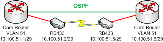

Just to expand on all this… and possibly spark an idea for someone, here’s what a typical backbone connection on my network looks like for a hybrid routed/bridged network: Management is routed, but we retain the capability to bridge VLAN traffic to/from any point on the network (MPLS/VPLS coming soon). All end-user traffic is bridged back to one of the core sites.
At the moment, we’re using Cisco routers at the core site (L3 switches to be precise), I’m working out the details to migrate to a pure MT network, but we’re not there yet. The core routers are connected over a ROS wireless bridge, using VLAN interfaces on a /29 network. This leaves 2 IP addresses available, which makes it super easy to bring up a new bridge when/if necessary, easing the pain of upgrades/replacements.
