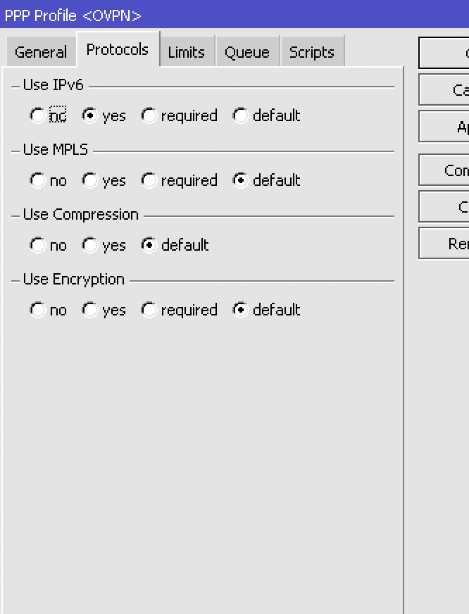

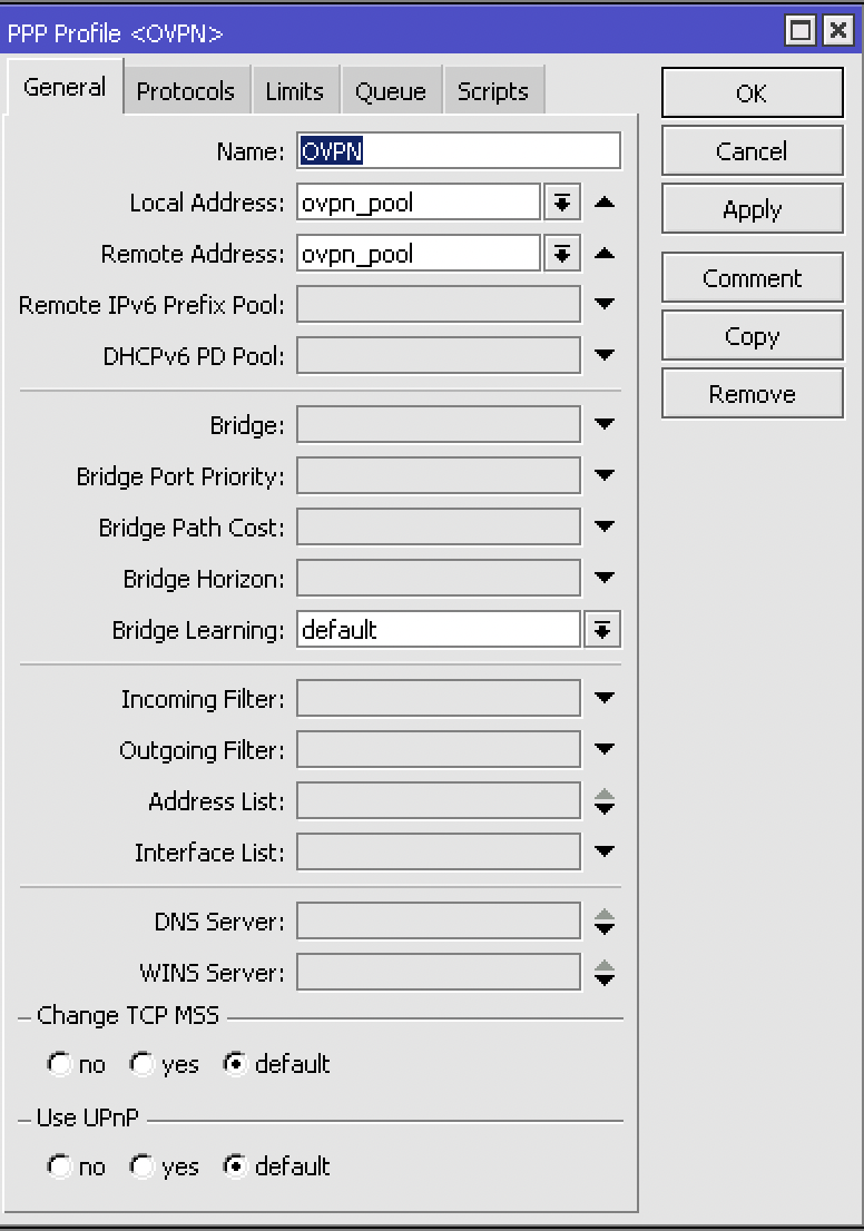

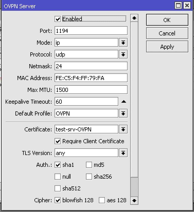

Updated my RB2011UiAS to ROS 7.1.5 to set up OVPN UDP server.
My ROS settings attached to the post.

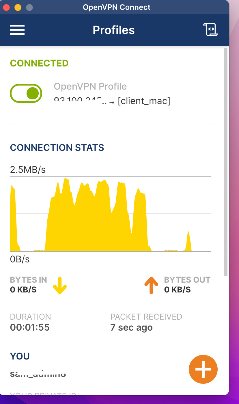

After setup I’ve got OVPN connects from Mac and Android. But problem is that it crashes after file transfer (After 60-70MB of traffic) and reconnects.
In microtik log I found such error
recvd P_DATA packet, dropping
I Updated to 7.3.1, and problem still exists, but with Mac I don’t see this error In log, only with Android, with Mac client I see this message
After OVPN crashes:
 disconnected <TLS failed>
Full Mac OVPN client log Here

@Sammie
Firstly, MT does not support TLS Auth.
tls-auth ta.key 1
Secondly, I had the same problem with OVPN and with Version 7.3 It has been fixed, you can check this post, both sides of my tunnel are MT.
OVPN Server
/certificate settings
set crl-download=yes crl-store=system crl-use=yes

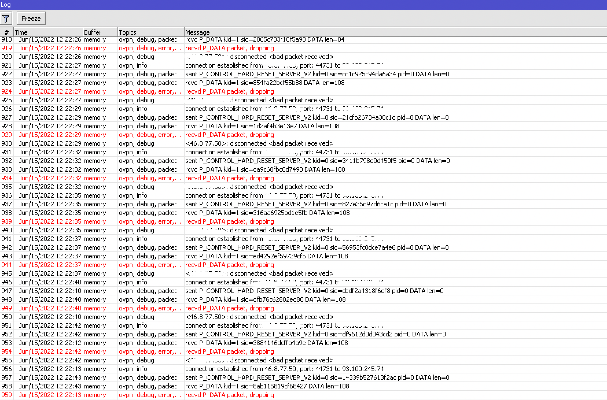

OVPN breaks also on android mobile…
here is log screenshot..
Check your config and certificates, something is not right.

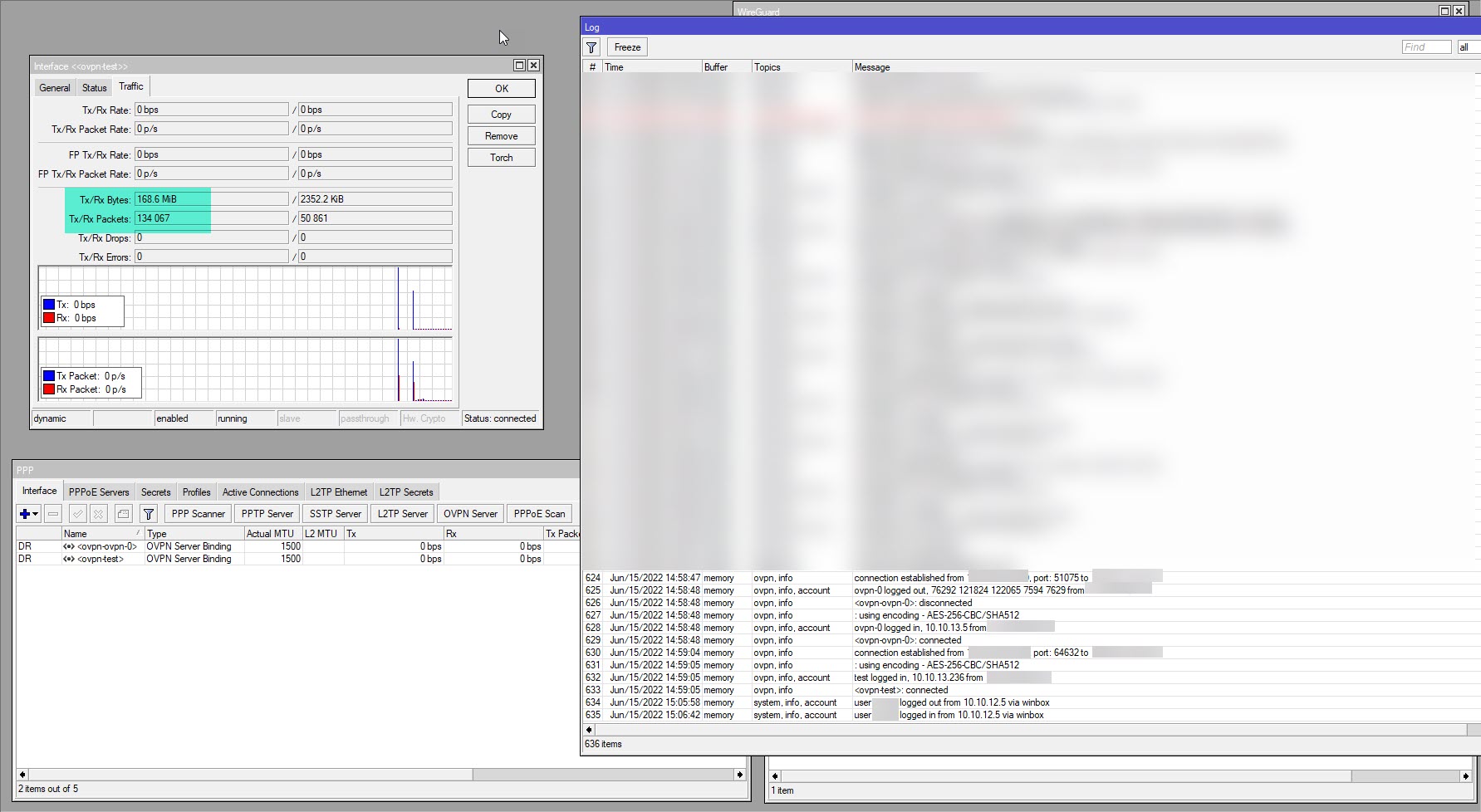

Reviewed everything, reissued all certificates according to manual https://wiki.mikrotik.com/wiki/Manual:Create_Certificates

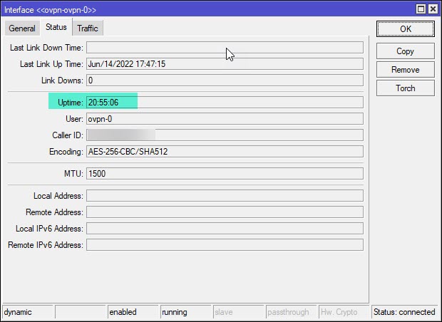

Situation changed to better) still there is ovpn breakes, but it reconnects and transfer continues :smiley:

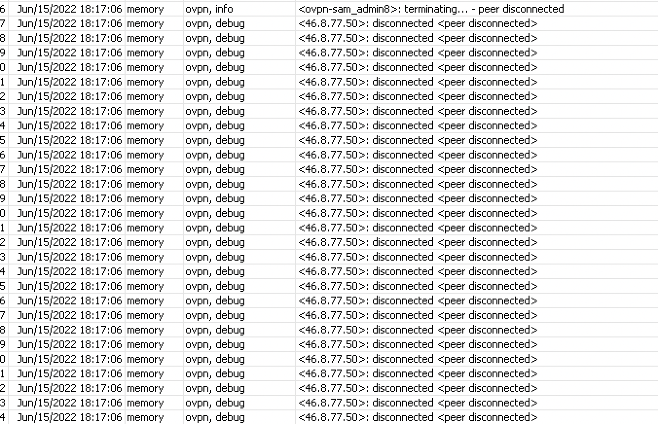

log in Mikrotik shows “peers disconnected”
Any ideas?

Do you have IPv6 on your router?
I have no ipv6 package installed..
