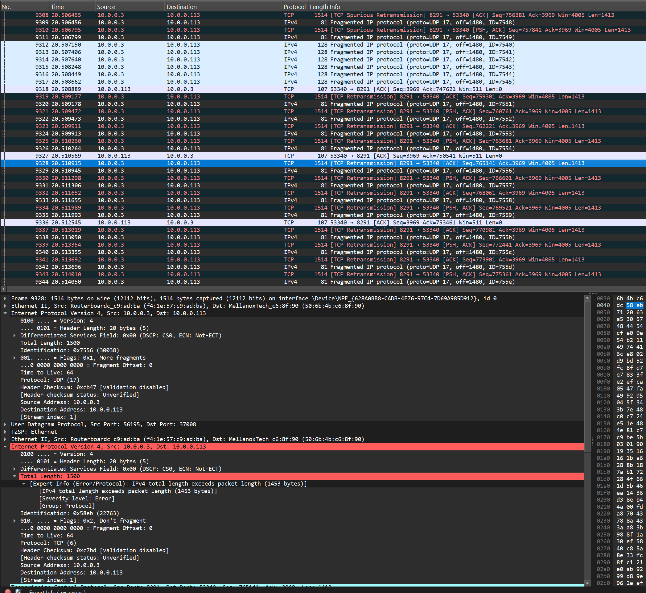

Traffic from the router to the first switch is clean. It starts dropping on the CRS518. If I turn packet capture on that very switch, the packet loss is instantly shown, regardless of what I do and reports the following:
IPv4 total length exceeds packet length (1453 bytes)]. MTU is 1500 across the board.

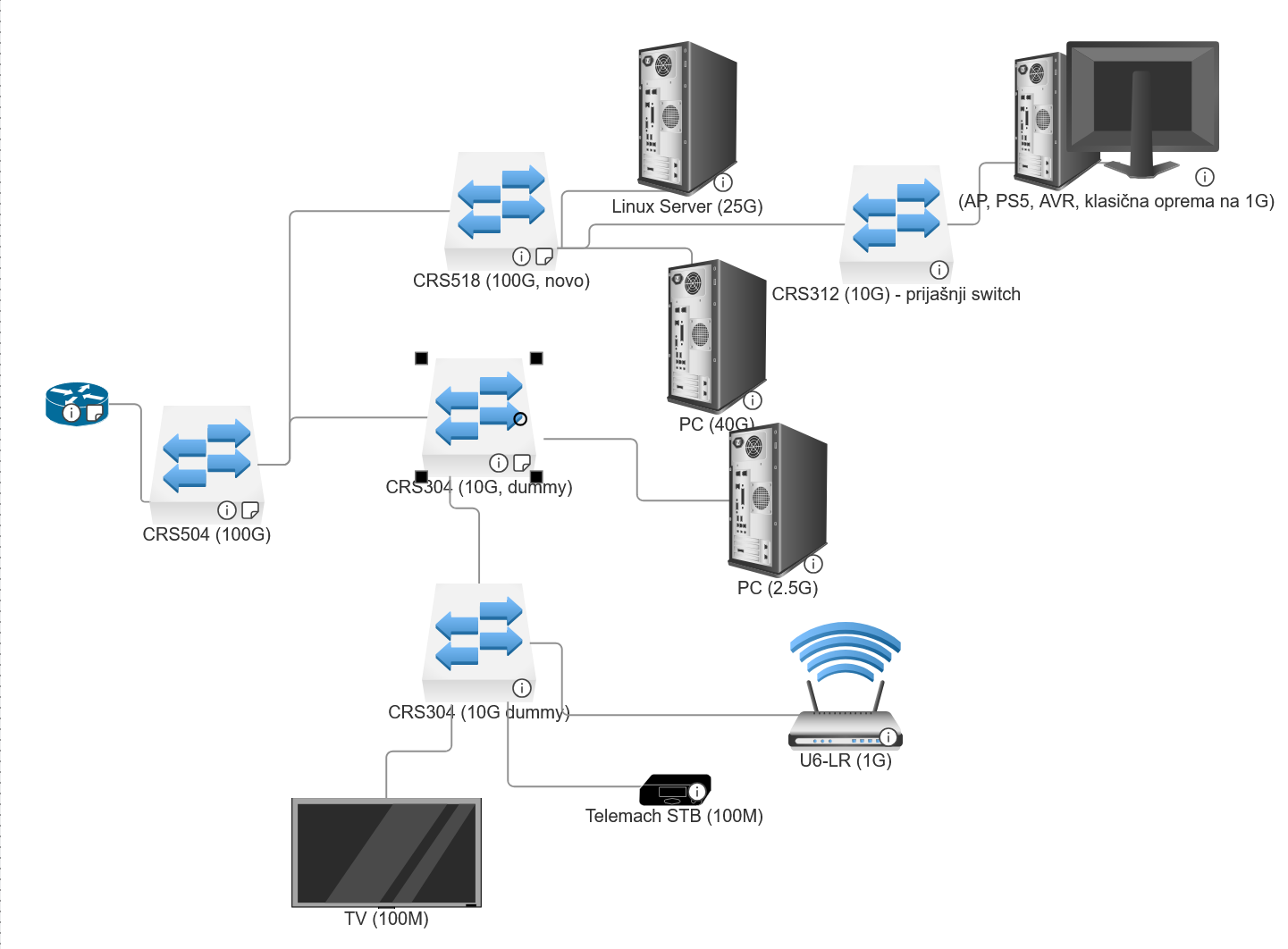

Network topology attached.

Am I seeing UDP encapsulated in TCP? If yes, why?
Traditional IPTV is seven MPEG-TS packets at 188 octets each per L2 frame, thus well under 1500 even after UDP framing overhead. (Inconveniently, 8×188=1504)

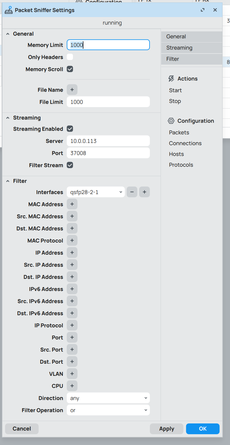

I’m running the capture like this:
