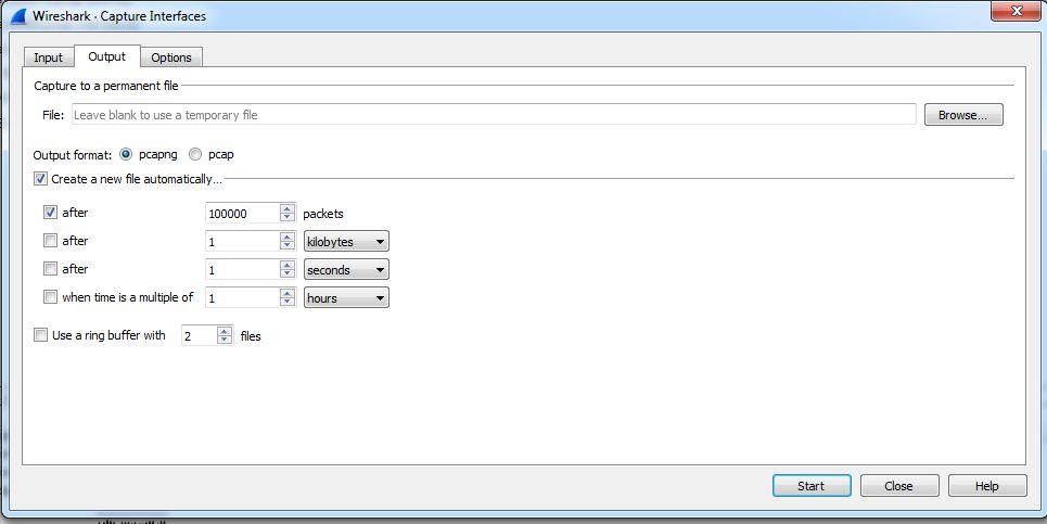

If the RTP ports aren’t easily predictable, I would configure Wireshark to write the packets to a file and then stream all traffic to Wireshark. In the screenshot example, this would configure Wireshark to start a new capture every 100k packets. This prevents the capture files from getting too large to manage. You can then open each file, filter out the traffic you don’t want, save to a file again, then use mergecap.exe to merge the desired traffic into a single file for further analysis.
