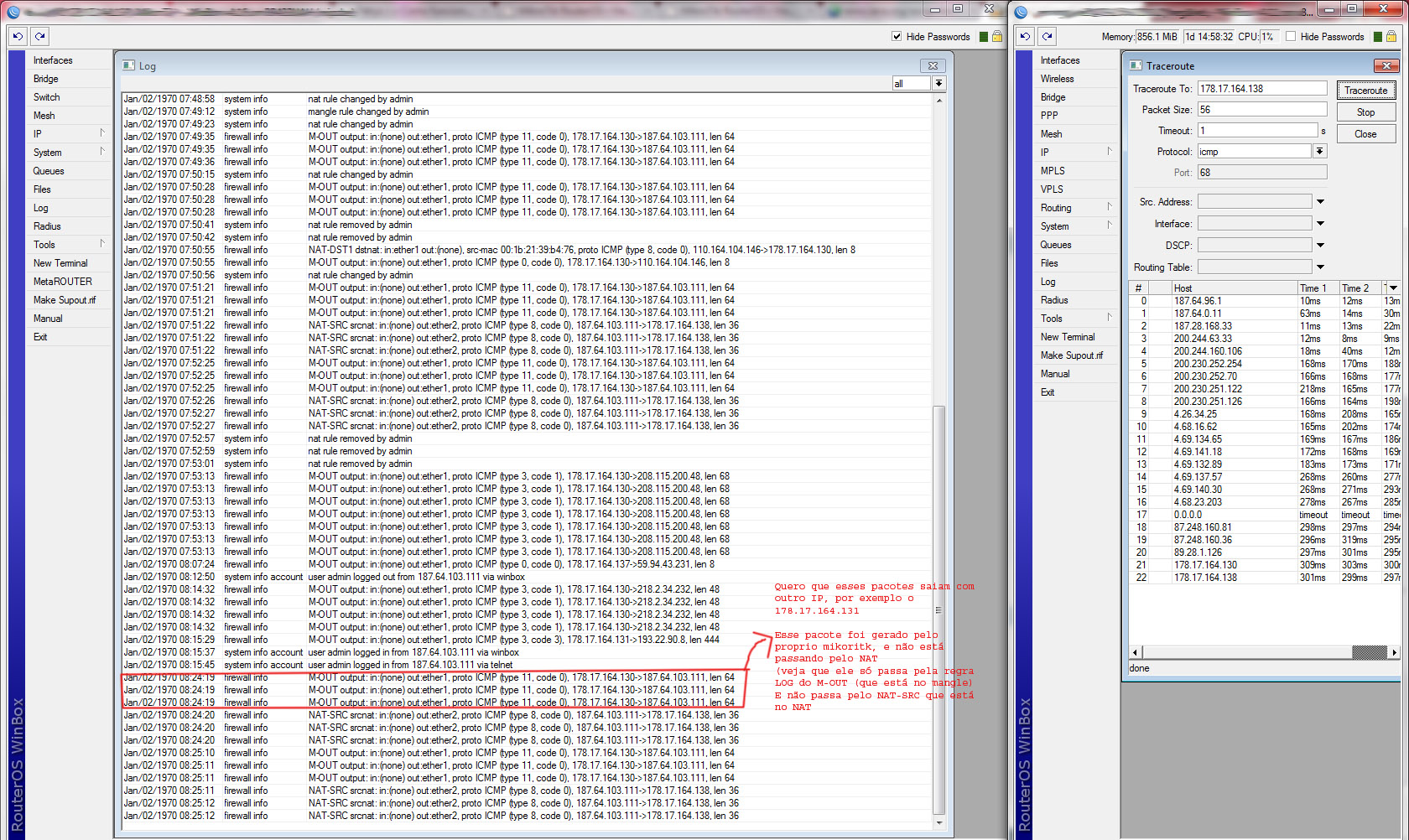

In my firewall there is only one rule:
/ip firewall nat add action=src-nat chain=srcnat comment=β€œβ€ disabled=no protocol=icmp src-address=178.17.164.130 to-addresses=178.17.164.131
But the resulting package does not hit the rule.
The package is generated by Mikrotik and has the following characteristics:
src-addres=178.17.164.130
dst-adress=187.64.103.111
protocol=icmp
out-interface=eth0
in-interface=(none)
OBS: icmp-type=11 ; icmp-code=0
