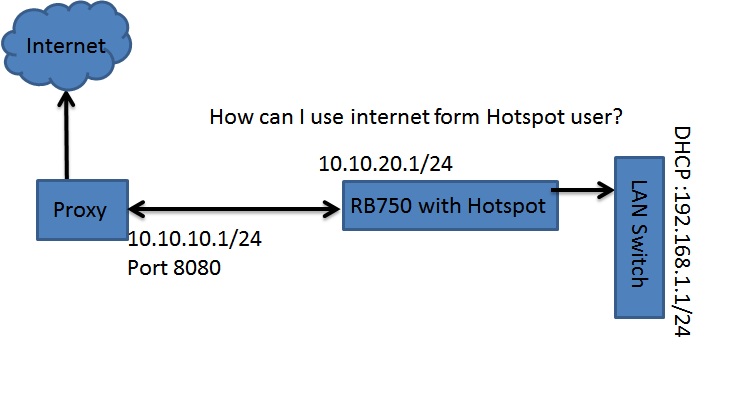

Parent Proxy for hotspot user
i cannot use internet from hotspot , i am able to login in hotspot
any one can guide for the same?
I see no issue while looking at the diagram you posted.
What problem you are facing in the current scenario ?

i am not access websites, if i used same proxy in laptop than only i can open web sites
i dont want to use proxy in laptop ,
so kindly guide to setup the same in mikrotik

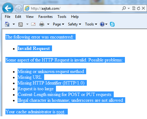

i did some iptable rules & NAT , i see error as below snap
is anybody resolved it?

Check your squid’s cache/access log, i guess there’s your clue (perhaps error with acl permission)

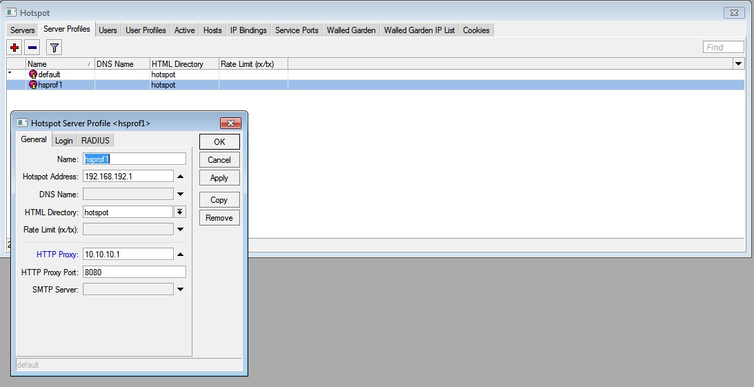

Configure HotSpot parent proxy at
 /ip hotspot profile http-proxy=
Dear,
its still no working
snap is attached
Thanks Sergejs
it works afterall
