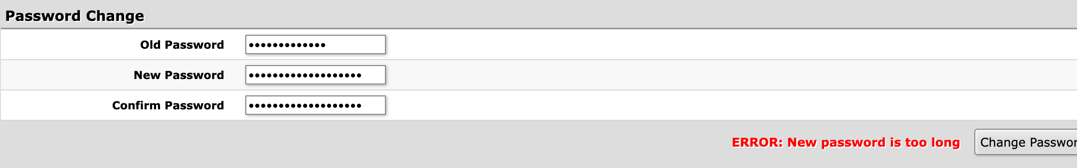

Long time Mikrotik and RouterOS user and got my first POE switch yesterday. Cannot describe my surprise and disappointment when setting up a new password in SWOS v2.16. Can’t change admin username to something else (normal practice), but more importantly: a 19 character password is too long!!!
I’ve come to expect better than this from Mikrotik. I appreciate it’s a switch and not a router but that’s no reason for poor architecture and design practices.

I believe you’re missing @mwiesenhaan’s point. A length limit implies that they’re storing the password in plaintext, thus that it can be retrieved and reused as-is.
If they were salting and hashing the password as has been standard practice since the 1980s, you could feed it a Tolstoy novel and it would still hash down to the same length. There will be practical limits involved — network receive buffers if nothing else — but that should be up in the kilobytes range, effectively infinite for the purposes of password inputs.

A sensible limit of that type will be based on a buffer size, as I indicated. 256 bytes is sensible. 1k is sensible. 64k is sensible. 18 smacks of a fixed-length plaintext field in a C structure stored as-is in the flash RAM; there are no common 144-bit hash functions.
What they ought to use that space for is 2 bytes of salt and a 128-bit hash output.
Keep in mind that we’re talking about SwOS which is limited by capabilities of switch chip (on devices which don’t support running ROS). So any buffers exceeding MTU (minus some application overhead) might not be sensible as the SwOS-side software might not be able to “de-fragment” buffers received … remember that SwOS lacks full-featured IP stack as well (it doesn’t support routes, it doesn’t support “native” software update checks, etc.). SwOS also lacks support for https, which IMO is much bigger problem than password length limitation.

The processor in the switch chips on SwOS-only devices is very limited so it is highly unlikely that any encryption can be added. From the Marvell datasheet Target Applications section “Smart and Lightly Managed switches: Integrated microprocessor enables lightly managed switches with the addition of an external EEPROM”
The password will likely be stored in a fixed location of the EEPROM, and certainly is transmitted and saved in hex-encoded plaintext when you backup the configuration - open the .swb file in a text editor and you will find an .pwd.b:{B:‘xxxxxxxxxxxxxxxx’} entry.
