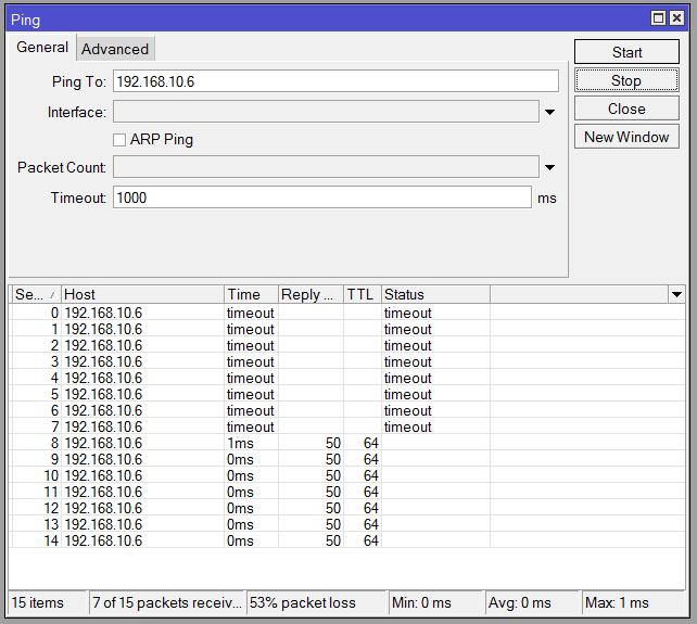

I recently bought several Mikrotik devices. I have massive performance problems with all of them.
I will begin with the brandnew switch CRS112-8P-4S.
All devices in network are checked with nagios. The ping to switch CRS112 fails with packet loss.
  • the firmware on all Mikrotik devices is 6.42.3
  • a ping from a hAP ac to the CRS results in timeout for the first 7-10 pings, then the pings work
  • I have ping the switch from other devices with the same result.
  • a ping between two hAP ac are ok
  • the switching power seems to be ok, the connected computers can send and receive with the full bandwith of 1GBit.

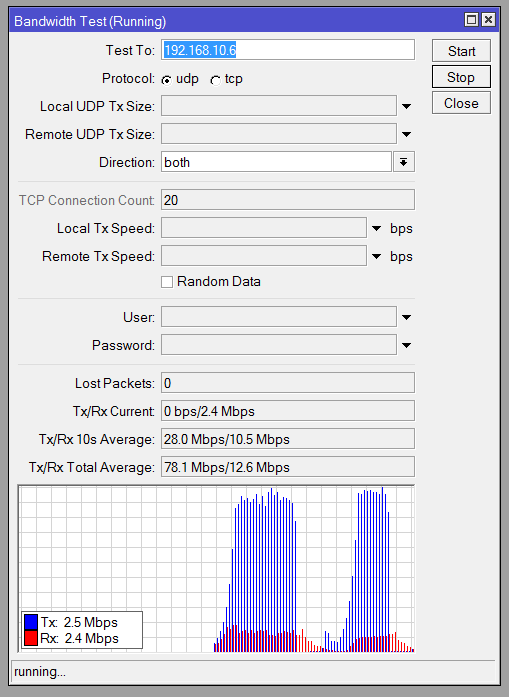

  • a bandwith test between two hAP ac is ok and I have full bandwith
  • a bandwith test between a hAP ac and the CRS112 results in a low bandwith of max 100MBit
  • in this case the cpu load of the CRS112 is at 100%
What can I do for a good performance of the device with working pings???

the further investigation locate the problem in the “Detect Internet” functionality.
  • the device requested two IP-addresses from DHCP server. One for the bridge and one for the port which was connected to an other switch with connection to the internet
  • I don’t know why the Detect Internet functionality was active
After deactivation of the functionality the device only requests one IP-address as axpected and now I can ping the CRS112 without timeouts and I can ping other devices from CRS112 without timeouts.
To the bandwith test issue the Mikrotik support says this is normal, the device has a slow CPU. Hmm…
If you want to test bandwidth, use three devices - one RX, one TX and between them, put the measured device. That way your results will be not affected by btest process.
Switch simply don’t have enough power to process so many packets in CPU. This is not performance issue but simple result of chosen hardware.
This might be true, but:
  1. A device in 2018 that can't handle wire-speed is pretty much garbage.
  2. The $75 Mikrotik devices out-perform this $225 device.
  3. I can't buy any more of these because if you try to use any of the features it drops the speed of your network.
The form factor is perfect. We would use this in every one of our distribution points.... if it would work.
It's a shame that such an otherwise ideal device has such a serious shortcoming as to make it unusable in production.
The “S” in CRS112-8P-4S stands for SWITCH. Stop trying to use it as a router and you won’t have these problems.
Is the best way to use these just as a switch to add a bridge and add all ports to the bridge?
I noticed the CPU increased significantly when adding VLANs even without any routing.
CRS1xx don’t offload much to hardware automatically. If they are only used as simple switches (no fancy features used), then the method of creating bridge and adding all ports to it is the way to go.
When you start using some fancy features (and yes, VLANs count as fancy on CRS1xx), you have to go with hardware config to unleash full performance … see CRS1xx/CRS2xx manual.
