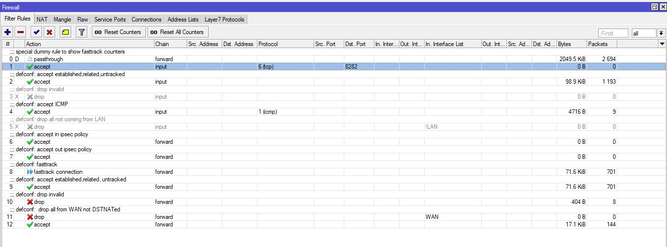

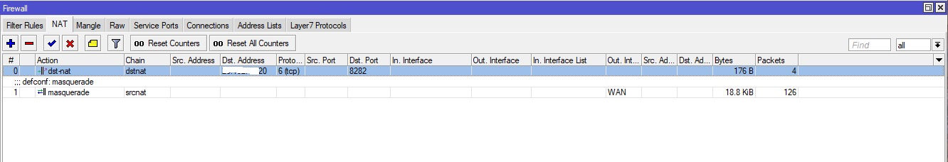

I gave up, on the winbox, but i needed also to permit port 8282 to access DVR, i created the forward and also DST NAT from public to private ip
and still shows it as filtered and not open if i scan via a online scan port website…
  1. Don’t post screenshots, they don’t show everything, post config export instead. In this case “/ip firewall export” could be enough.
  2. Firewall rule #1 is useless, input chain is for services on router itself, not for forwarded ports.
  3. By disabling firewall rule #5, you opened every service on router to whole world. So on the upside, even access to WinBox from internet should now work. But it’s probably not the best idea (see previous posts).
  4. You don’t need rule #12, implicit invisible accept rule at the end already exists.
  5. Assuming your dstnat rule is correct, and since you (as it seems) didn’t change much in default firewall, it should work. You already have some incoming connections matched by the rule. So also check if the target device is configured correctly.

You still have all access to router open (see point 3 in previous post). But other than that, there’s nothing wrong. So try to watch packets more closely. You use either Tools->Torch, or some logging rules, e.g.:
/ip firewall mangle
add chain=postrouting dst-address=192.168.0.201 protocol=tcp dst-port=8282 action=log log-prefix="packet to DVR"
add chain=prerouting src-address=192.168.0.201 protocol=tcp src-port=8282 action=log log-prefix="response from DVR"
The first rule should log some packets (if dstnat rule logs something, it should be here too). The second rule will only log something if DVR responds. If it doesn’t, you need to check what’s wrong there.
