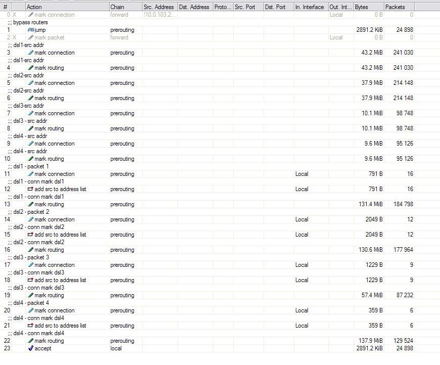

here’s the config:

/ip firewall mangle
add action=jump chain=prerouting comment="bypass routers" disabled=no \
    jump-target=local src-address-list=routers
add action=mark-connection chain=prerouting comment="dsl1-src addr" \
    disabled=no new-connection-mark=dsl1 passthrough=yes src-address-list=dsl1
add action=mark-routing chain=prerouting comment="dsl1-src addr" disabled=no \
    new-routing-mark=dsl1 passthrough=no src-address-list=dsl1
add action=mark-connection chain=prerouting comment="dsl2-src addr" \
    disabled=no new-connection-mark=dsl2 passthrough=yes src-address-list=dsl2
add action=mark-routing chain=prerouting comment="dsl2-src addr" disabled=no \
    new-routing-mark=dsl2 passthrough=no src-address-list=dsl2
add action=mark-connection chain=prerouting comment="dsl3-src addr " \
    disabled=no new-connection-mark=dsl3 passthrough=yes src-address-list=dsl3
add action=mark-routing chain=prerouting comment="dsl3 - src addr" disabled=no \
    new-routing-mark=dsl3 passthrough=no src-address-list=dsl3
add action=mark-connection chain=prerouting comment="dsl4 - src addr" \
    disabled=no new-connection-mark=dsl4 passthrough=yes src-address-list=dsl4
add action=mark-routing chain=prerouting comment="dsl4 - src addr" disabled=no \
    new-routing-mark=dsl4 passthrough=no src-address-list=dsl4
add action=mark-connection chain=prerouting comment="dsl1 - packet 1" \
    connection-state=new disabled=no in-interface=Local \
    new-connection-mark=dsl1 nth=4,1 passthrough=yes
add action=add-src-to-address-list address-list=dsl1 address-list-timeout=1h \
    chain=prerouting comment="dsl1 - conn mark dsl1" connection-mark=dsl1 \
add action=mark-routing chain=prerouting comment="dsl1 - conn mark dsl1" \
    connection-mark=dsl1 disabled=no new-routing-mark=dsl1 passthrough=no
add action=mark-connection chain=prerouting comment="dsl2 - packet 2" \
    new-connection-mark=dsl2 nth=4,2 passthrough=yes
add action=add-src-to-address-list address-list=dsl2 address-list-timeout=1h \
    chain=prerouting comment="dsl2 - conn mark dsl2" connection-mark=dsl2 \
add action=mark-routing chain=prerouting comment="dsl2 - conn mark dsl2" \
    connection-mark=dsl2 disabled=no new-routing-mark=dsl2 passthrough=no
add action=mark-connection chain=prerouting comment="dsl3 - packet 3" \
    new-connection-mark=dsl3 nth=4,3 passthrough=yes
add action=add-src-to-address-list address-list=dsl3 address-list-timeout=1h \
    chain=prerouting comment="dsl3 - conn mark dsl3" connection-mark=dsl3 \
add action=mark-routing chain=prerouting comment="dsl3 - conn mark dsl3" \
    connection-mark=dsl3 disabled=no new-routing-mark=dsl3 passthrough=no
add action=mark-connection chain=prerouting comment="dsl4 - packet 4" \
    new-connection-mark=dsl4 nth=4,4 passthrough=yes
add action=add-src-to-address-list address-list=dsl4 address-list-timeout=1h \
    chain=prerouting comment="dsl4 - conn mark dsl4" connection-mark=dsl4 \
add action=mark-routing chain=prerouting comment="dsl4 - conn mark dsl4" \
    connection-mark=dsl4 disabled=no new-routing-mark=dsl4 passthrough=no
add action=accept chain=local comment="" disabled=no

This screen shot may help to visualize my setup:
