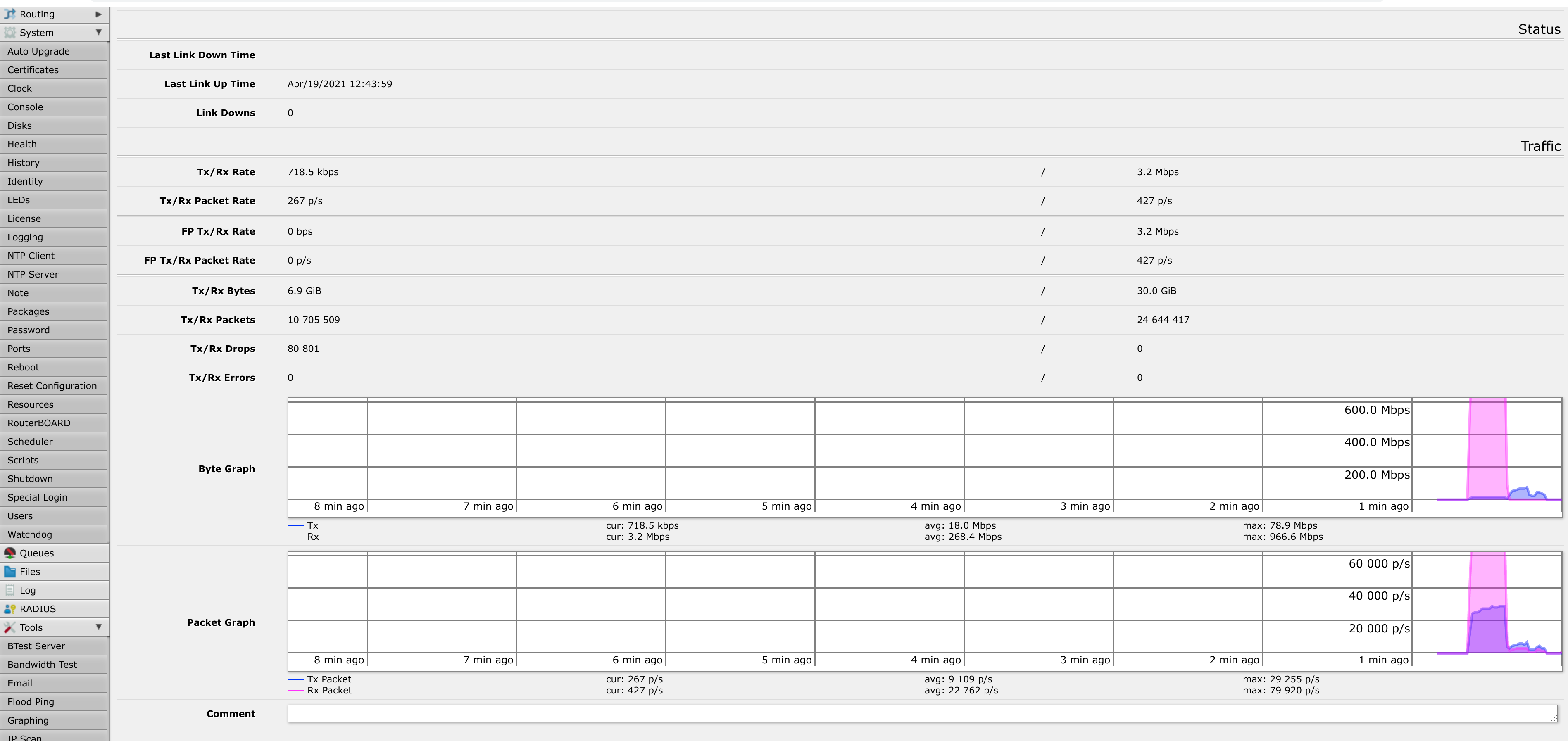

I have a RB4011 connected to a CRS305 with a router-on-a-stick topology, with sfp-sfpplus1 on RB → sfp-sfpplus1 on CRS, both with 10G ethernet SFP+ modules. The sfp-sfpplus4 port on the CRS goes to the ISP’s fiber internet CPE which provides a public IP address to the RB4011 on the VLAN 10 network that I set up between the RB and CRS. The problem is, I can’t get past around 60 Mbps on upload, while I can get an easy 900 on download. I’ve checked everything including fasttrack, queues, CPU usage, accidental VPN usage, but no luck. The weird part is that when I connect straight to the CPE, I get an easy 900 Mbps upload speed, the same as download because I have a symmetric gigabit connection. This also never happened before the router-on-a-stick setup so the problem has to be there. I get hw-offloading on ALL the ports of the CRS305, even with VLANs and bridge VLAN filtering, so it’s not a switch chip issue. When doing a speedtest, the RB4011’s CPU reliably goes to around 90% on one core when doing download but 10% on upload, so it’s definitely powerful enough. Also, bridge VLAN filtering is enabled on the RB4011 but it might not need to be. What is there left to check? I haven’t touched MTU or flow-control or anything like that.

Update: I fixed the problem. Here’s what I figured out: The AT&T gateway only has regular gigabit ethernet. The CRS has a sfp+ module connecting to one of those gigabit ports, and it turns out that it was auto-negotiating to 10Gbps. This obviously couldn’t work with the AT&T gadget but it happened anyway. So what I suspect happened is that the sfp+ could understand the 1Gbit ethernet packets sent by AT&T, yet when it tries to send the 10Gbit packets the gateway could only understand enough of them to give me that 60Mbps upload speed. The fix was to swap out the sfp+ module for a plain old sfp, and now that auto-negotiates to a reasonable 1Gbps. I couldn’t get 1Gbps to work on the sfp+ for some reason, as it kept getting a link but no packets could be passed. Additionally, the auto-negotiation speeds were set at a maximum of 1Gbps but kept switching to 10. Now I can get an easy 940/940 internet experience.
