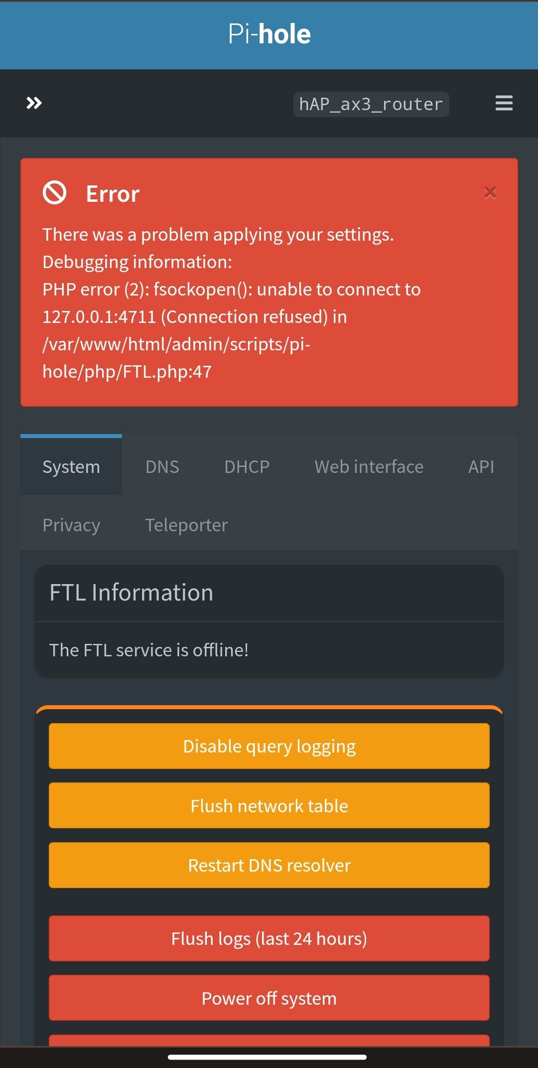

EDIT: Here is screenshoot of the error that I also get:
