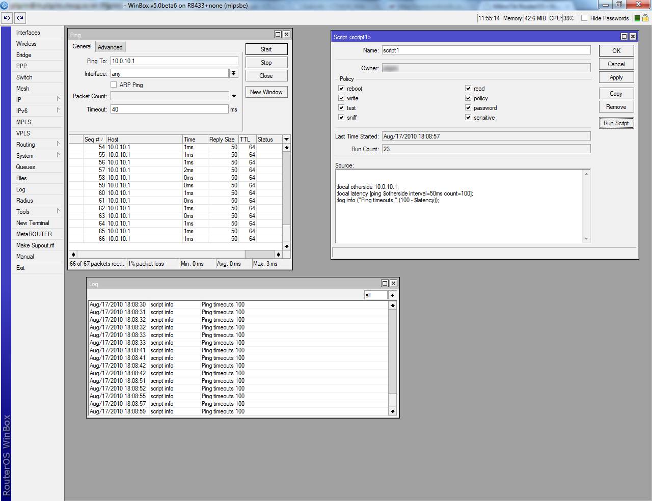

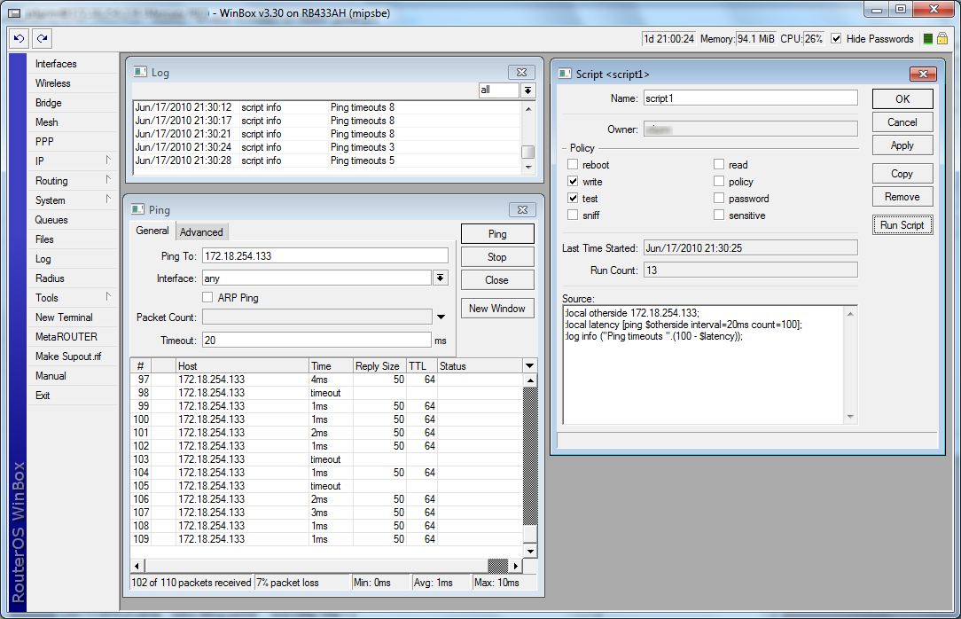

I recently loaded a script on a routerboard running ROS 5.0 beta3 and the output is not what I expected.
The following is an extract of the scrip to illustrate the problem:
:local otherside 172.18.254.134;
:local latency [ping $otherside interval=20ms count=100];
:log info ("Ping timeouts ".(100 - $latency));
On a rb running ros 3.30 it works perfectly, yet on the new rb running ros 5.0 b3 it does not. I double checked by running the ping in winbox, and it is correct. The log output should contain the amount of pings that timed out, yet it prints 100 (meaning the result of the ping command was 0). Please see attached images.

Good day. I have been busy on a different project for a while now, and have only recently had time to look at this ping script again.
I loaded Ros5 beta 6 and the ping script is still not working.
I will send a mail to support as well, I just wanted to keep this thread updated too.
Please see attached image for the results.
Best regards :slight_smile:

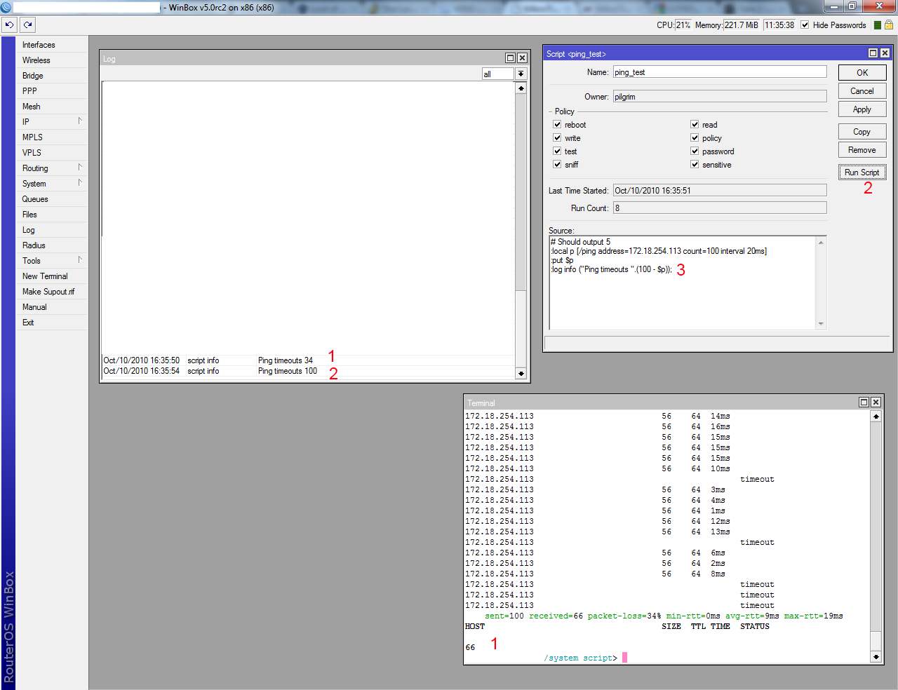

Hi dssmiktik, thanks for the reply.
I checked and yes, it looks like the ping works when you run the script via the terminal. But if you run that script by running clicking the icon on winbox or via the scheduler it does not work.
Please see attached screenshot:
1 - ran via terminal, output is correct.
2 - ran via winbox, output is wrong.
3 - i use Log to output the variable because I do not intend to run the script via console every 5 minutes on 100 routers.
P.S. This ping script is a small part of a much larger script.
Sorry, I missed the part about only running it via winbox (not terminal).
I’m getting very weird results as well. When I run via terminal, the terminal output and log both show correct values. When I run via winbox, the log shows an empty entry, completely blank. Also, when I run :execute “/system script run ”, completely blank log entries are created.
