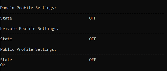

Disable firewall on one of the machines that does not respond to ping.
If you have Windows machines, open a command prompt and run:
netsh advfirewall show allprofiles state
Make sure the results are as in the image below:
If ping works with firewall disabled, enable the firewall and create a rule to allow incoming icmp.
