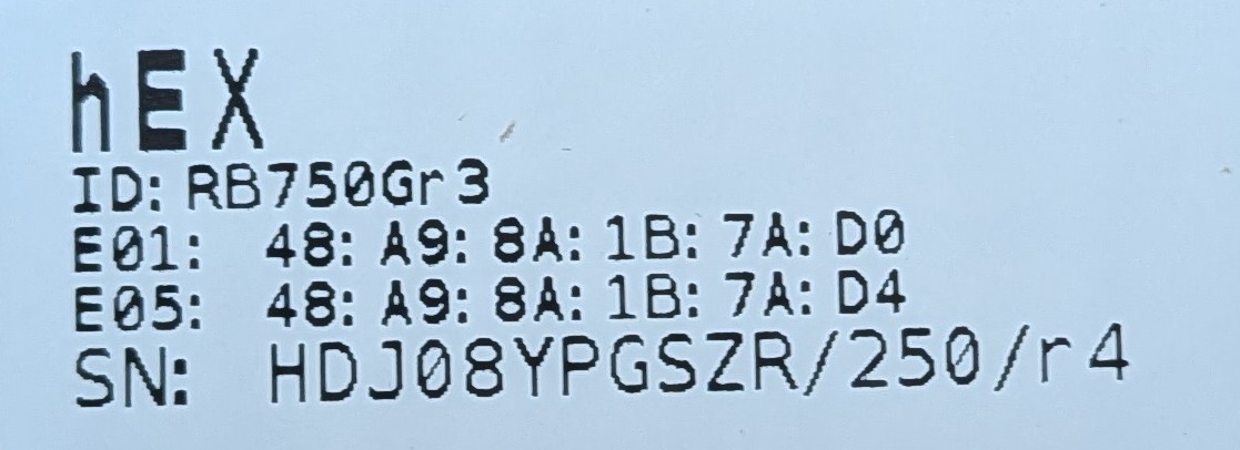

Trying to understand the post :face_with_monocle:
What model of Mikrotik do you use? Does it have WiFi at all?
Did you manage to install ROS 6.49.19 on it?
What type of cable? What does it connect and how?
Where Lte does not appear?
What ideas do you expect?
No Wifi
Yes, using latest firmware version.
USB-C cable, used to connect smartphone to router for USM internet tethering
LTE should appear when connected as a new interface under interfaces. It does not.

Let's clarify: are you running a USB cable from the hEX to the smartphone and expecting that this will turn the router into an LTE/5G-connected router?
I am running a USB cable from my smartphone (with USB tethering enabled) to the HEX so that the internet data from the phone is shared on the HEX's lte1 interface for backup use if/when the main internet source is down.
