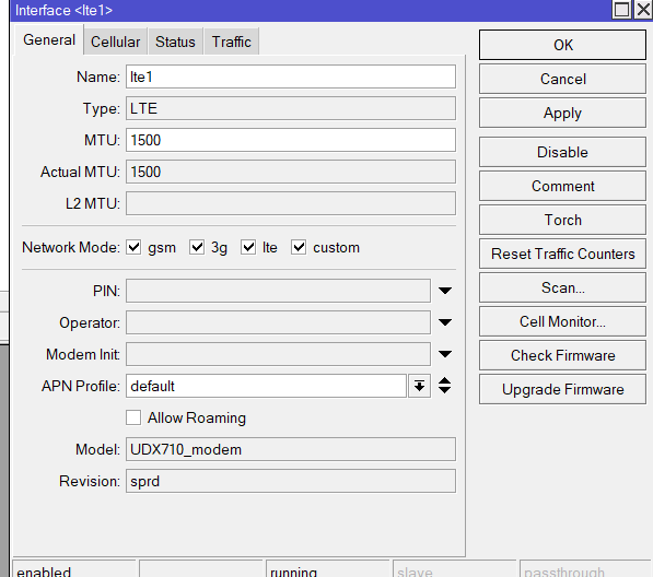

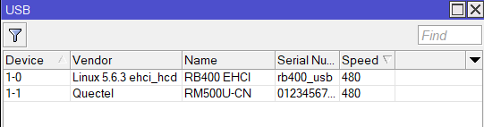

With this firmware the USB device show up okay
The interesting part starting when I check the LTE interface, on the network mode show up as custom not 5g and can’t select the bands and the model is not show up correctly but I guess for that box just picking up a different hardware info

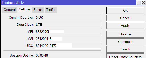

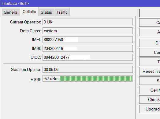

LTE connection working fine but no info which band it’s used
Also I can go with data class custom not sure what in the background in here 5g or CA for 4g
Sadly AT chat support missing for this modem so can’t really see what’s happening but I can get a resonable speed
