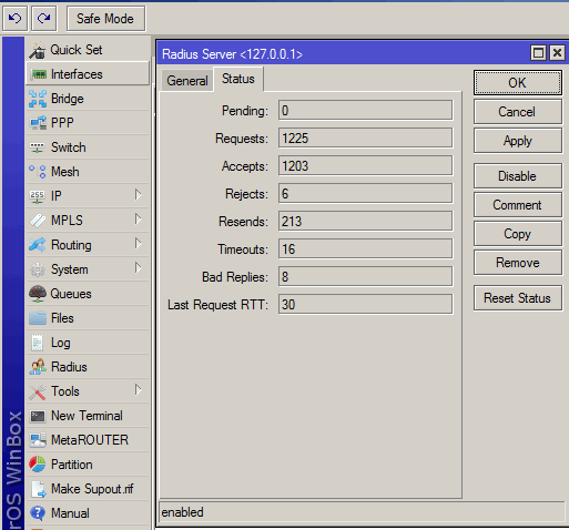

Could you post a screenshot of radius Status tab?

here is my RADIUS Status

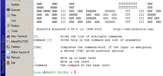

I use ROS 6.35.4
and I use RB750r2
so, Can I update the ROS to 6.40 ?
I mean, is 6.40 version is good for my RB750r2?

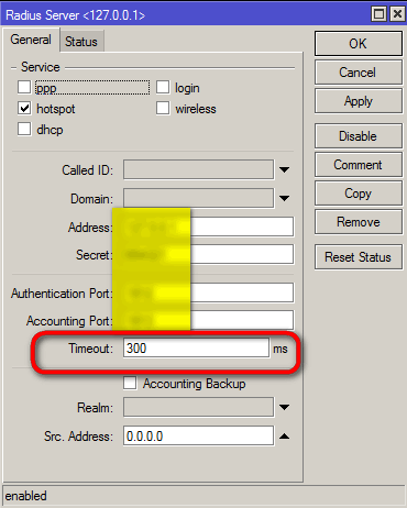

and I use RADIUS timeout 300
must I try it change to 3000 ?
What was the router uptime when you posted that status screenshot? Doesn’t look like unresponsive radius on that screenshot; I thought it was actually an external radius server, not user-manager running on the same router.

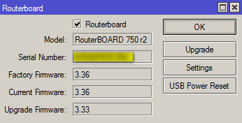

Yes, you should upgrade to current 6.40.1, check System > Routerboard afterwards that Current Firmware matches Upgrade Firmware.
  • Set timeout to 1000
  • look again at status after 24hours
actually, the condition now was OK. and I post screenshot above when my router was ok.
I am still not found any error again till now, after make a change for set timeout of radius to 3000 and idle time hotspot profile to 15 minutes.

here is SS for my router ROS version.
