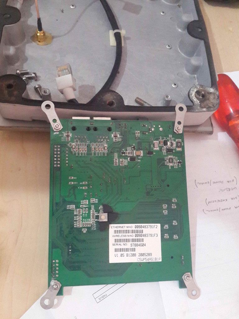

A few years a go I was told this is a Mikrotik board…? I need to ID it and find a proper power source.

definitely not a mikrotik board.
the MAC address indicates “Compex, used by Commodore and DEC at least”
This is defiantly not RouterBoard, it could be running RouterOS through.
Try with small voltage like 5v, but high AMP like 2-3 DC PSU and see if its powers up. try then higher voltage 9v … 12v.

It’s an old Compex board featuring Infineon MIPS CPU (as far as I remember it was ADM5120) It has 54Mb A/G card mounted.
WP54-* series of Compex boards can be powered using 12V 1A power supply (plus on the pin) or passive PoE 12-24V.
if it is not x86, it can’t run RouterOS. So it must have some other OS then
Yes they’re definitely Compex.
I cannot get it to switch on (12v/24v).. probably fried anyway.
I’ve found another one (WPE54AG) which I got working with 3.3v
Anyway thanks for the info. Sorry for Compex questions here…
