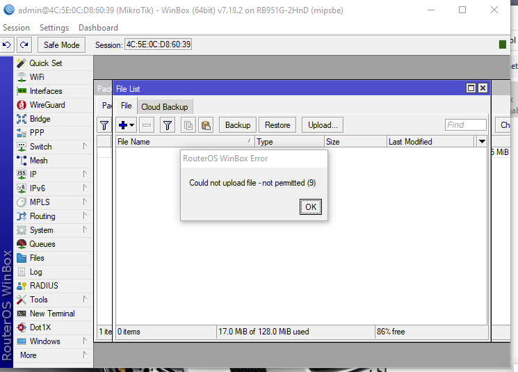

]I’m happy to be part of this great forum I’m grad someone can come to my rescue I’m new to routeros, i upgraded from 6 to 7 but unfortunately my userman starts giving me (error 404) which i decided to downgrade back to 6, that’s where the nightmare start, i follow the normal procedure to downgrade without using netinstall but when try to drag the routeros i got ( Could not upload file - not permitted (9) i cant transfer any file to my package i got same error, and the worst thing is i mistakenly deleted my wireless, i have only access to lan cable, im struggling to use netinstall with difference guide but i cant get it right, my Device doesn’t shows on netinstall i use window 7 64bit and window 10 64bit, please i need assistance to get my device back to normal either version 6 or 7
When trying to upload files, are you logged in as user with admin rights? Can you change any other setting (e.g. disable WAN port)? If the answer to first question is yes and to second question no, then your router is “owned”, hacked … and you no longer have admin rights. The only way out is netinstall (which is s pretty fragile process).

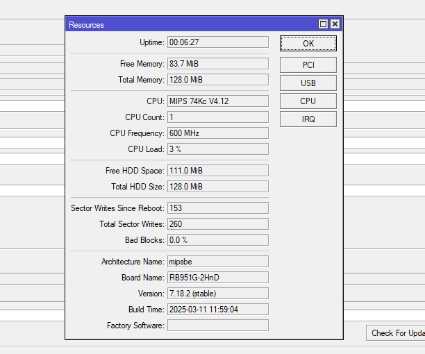

The “total sector writes” number is very suspicious, it’s low even for a completely new device (I don’t think the counter is reset when upgrading or netinstalling).
yes Sir i login with admin and my password, also i can change other settings like add bridge add ip…etc and in quick set i have only one interface which is ethernet after deleted wireless app from the package, please is there anyway out to try?
Well … files section, by default, should contain a couple of directories at least (pub/ and skins/), yours is empty. It’s hard to tell what’s wrong. I’d go for netinstall.

Regardless the instructions in my previous post: be prepared for failure. It cpuld well be that your RB951G reached the end of its flash disk life and if that is so, no amount of netinstalling will get it healthy again. I realky don’t like the number of “total sector writes” being that low. My RB951G, which is around 9 years old and was netinstalled a few times (the last time probably around 2 years ago), upgraded countless times … has counted around 24M sector writes. I don’t remember ever seeing it reset to 0.

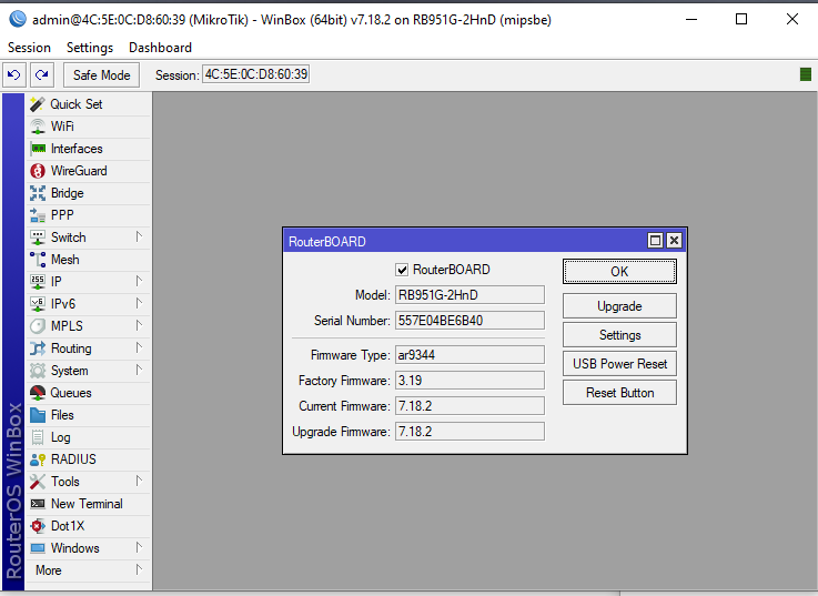

Finally my router is back after multiple trying to show on netinstall using window 7 64bit, i don’t know what happened , but after using the latest netinstall that is when it finally appeared the i choose the 7.18.2 then after successful install then downgrade to 6.49.18, Thank you very much for your help
