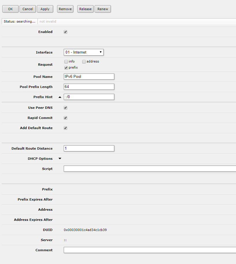

I am stuck with IPv6 setup for home.
I can not get prefix from my provider (or at least i don’t know how to). And also bridge mode is not possible (or not without payment).
This is what of options i get from my ISP:
When i try to ask for prefix i get nothing.

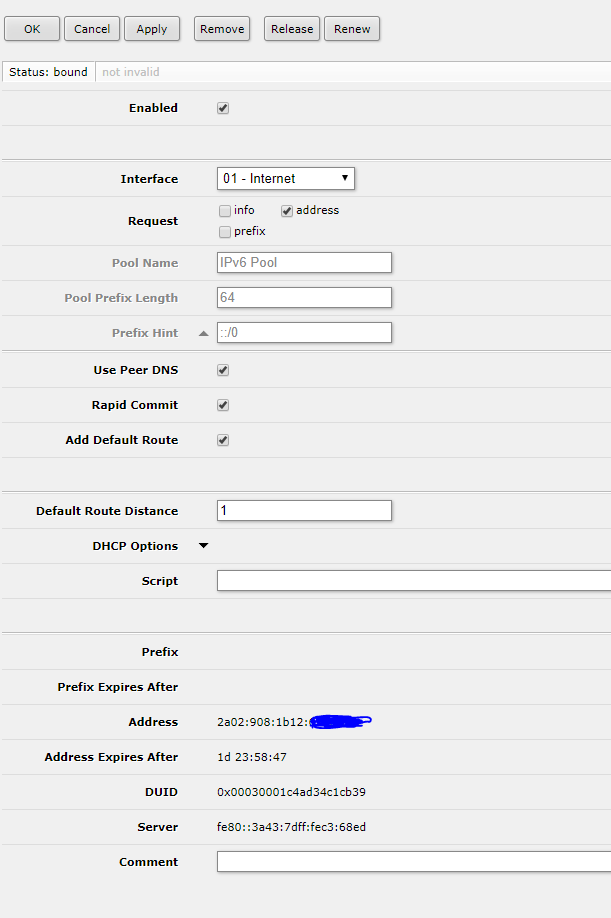

I have tried in my home router setting both Stateful and Stateles, and every time i got only address:
Now i need help how to setup IPv6 across devices.

I think, DHCPv6 server should be stateful and providing a shorter than /64 block, such as /60 , then your DHCPv6 client device can get a /64 with DHCP prefix delegation.
