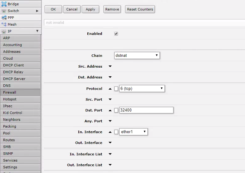

Had to get on-site support from an IT friend of mine, but finally got it to work. See Attached screenshot of NAT Rule-> IP/Firewall/NAT/Add New
Forgot to mention, under the “Action” tab
Action-> “dst-nat”
To Addresses-> “192.168.00.000”
To Ports-> “32400”
Thank you… a great posting which explains how to set up Plex access outside the local network. Also it works, a bonus!
I have the same rule, includin
g the subsequent clarfication. Plex connects briefly and then disconnects and shows the server not reacheable from outside notice. Wondering whether other Firewall rules might interfere.
