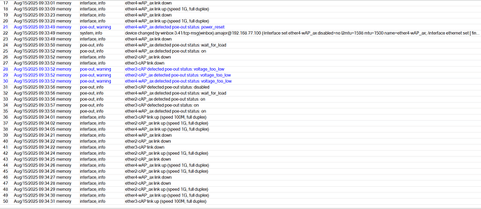

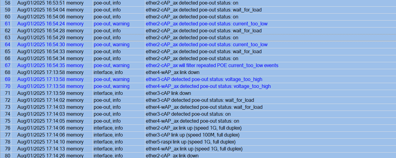

I have an RB960PGS.3 CAPs are connected and powered via POE. Adapter used in this router is 48POW. After upgrading to RouterOS 7.19.4 (routerboard firmware also upgraded) I can see this log messages. Earlier I had no problems. Does anybody any idea why? All cAPs run on latest 7.19.4, all routerboard firmware upgraded .

I've changes the settings only on 1 port connected to wAP ax back to "auto-on" and immediately I got error messages:

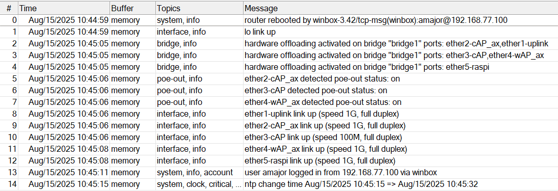

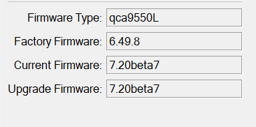

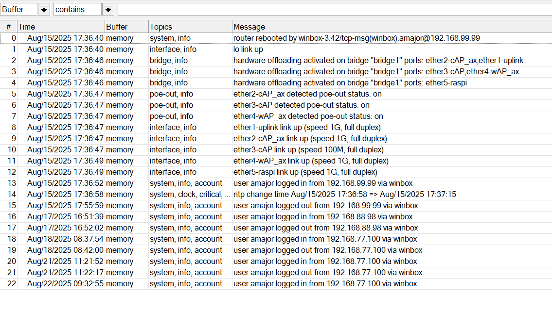

OK, I did it, now that unit is on 7.20.beta7. Firmware too. I also set back the Poe to "auto" on all capable interfaces.
Log is clear now:
I come back with results.

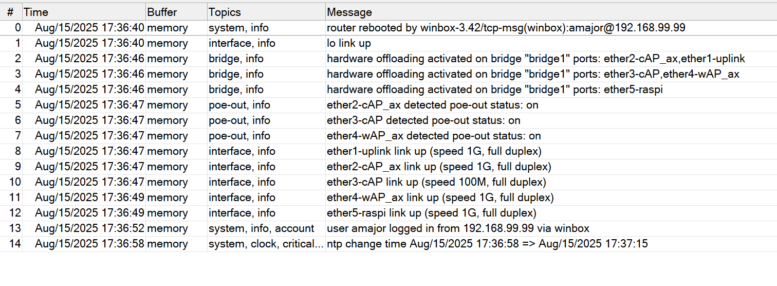

Upgraded to 7.20beta8. firmware also. log clear.Come back
Hi All,

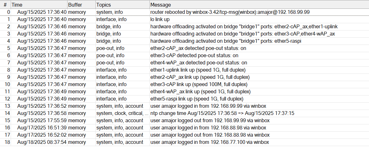

hEX POE with 7.20.beta8 works fine in the last 2,5 days, no POE error messages in the log.
Still works fine, no poe-out error messages.
