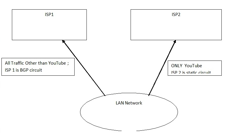

We are running a small network with two ISPs as primary and secondary. The secondary one remains idle most of the time.
We wish to route only the youtube traffic on the second one. For this mangle rule was created and an address list of you tube is formed.
However, I am not able to figure out on how to forcibly route the traffic for the address list on ISP2.
Please suggest.
