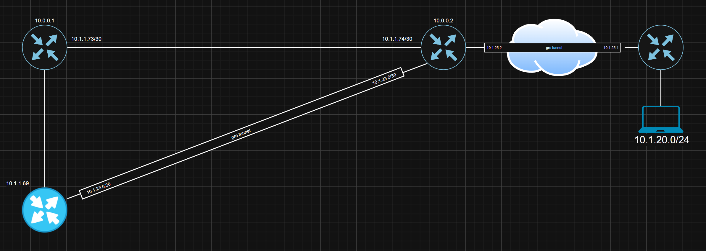

i've what seems like a simple little routing situation here that's really kicking me to the curb.
our gateway router, 10.0.0.2, is advertising a default route to devices through a gre tunnel to a different site who's routers we don't control. when the traffic from those devices comes in, i need it sent through an inspection appliance (10.1.1.69) before being allowed out on the internet, or to resources behind 10.0.0.1.
i'm open to suggestions if i have the best implementation here. i used the gre tunnel between 10.0.0.2 and 10.1.1.69 so i can have a single policy route to control all the traffic right as it appears through the gre tunnel from the other site.
i've blown multiple days into trying to make this work with mark routing, so i'd really appreciate the help. mark routing is new to me, so details would be appreciated.
when doing a packet capture on 10.0.0.2, it seems the traffic is being sent out to the internet, but has no path back? it's a real head scratcher to me..
i would also be fine with letting the traffic go from 10.1.1.69 directly to 10.0.0.1 and then out to the internet via 10.0.0.2 if that's the more correct thing to do. but allegedly asymmetric routing is generally best avoided.

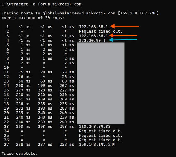

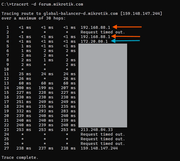

Result:
  • Client on ether2, for example 192.168.88.254 sends packets to the internet, for example to forum.mikrotik.com at 159.148.147.244, using the CHR at 192.168.88.1 as gateway.
  • Raw notrack rule makes sure this is not tracked.
  • Routing rule directs this packet to use via-rb routing table
  • Routing table via-rb has default route using 10.12.1.1 (on ether1) as gateway.
  • Packet is directed to 10.12.1.1, this router logs and sends the packet unchanged back to 10.12.1.247 (address of CHR on ether1.
  • Packets is processed normally by firewall with connection tracking, because in-interface=ether1, both RAW rule and routing rule no longer match this packet.
  • Packet uses default main table, which has 172.20.80.1 on ether3 as gateway, NAT is applied correctly.
  • Response packet arrived via ether3 are processed normally by conntrack and are un-NAT-ed and send back to 192.168.88.254 via ether2.
Connection works normally. We can see in the traceroute the two times the packet reaches 192.168.88.1 (which has the role of 10.0.0.2). The 2nd hop is the 10.12.1.1 "appliance".
